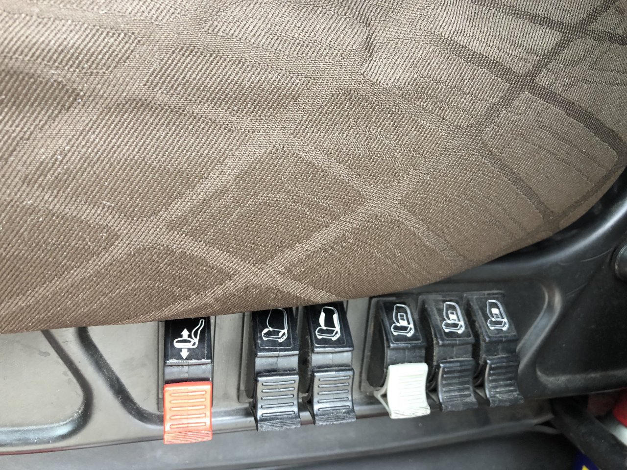

    Hi, I have an air leak from deiver side seat on both side bolster switches. Manipulating the toggle for a while helps temporarily, but I have to do it every time.
    Does anybody know if I can buy those toggle switches separately?
    It’s a 2015 Volvo Vnl. I beleive they are base seats.

    It's a National Seat, you can grab the bottom cushion from the rear at point where it meets the back cushion and pull it up, (it's on hinges) and access the switches from there.
    It's probably a bad o-ring in the fitting, or the air line may not be secured very well.

    Thanks, I did just that this morning. Air lines are not leaking. It’s the switches, they are bad.
