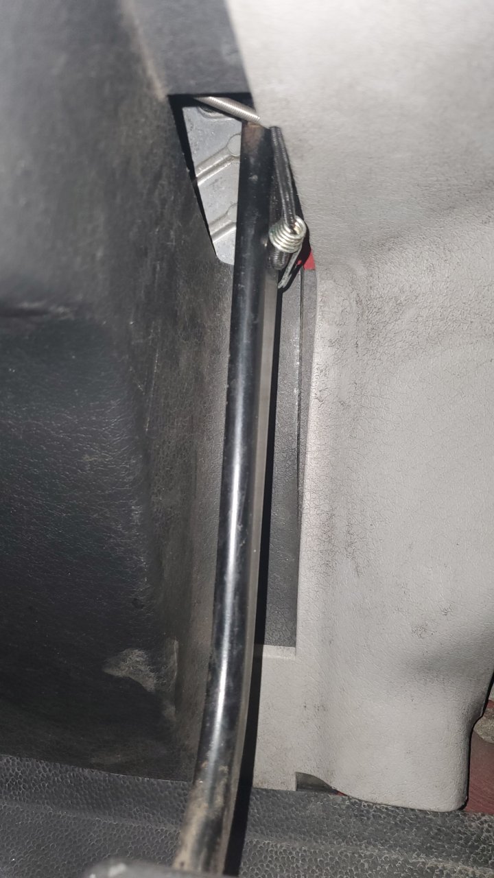

What i did was pull clutch petal up and it worked when came in just replaced the spring behind it i have 2006 vnl 670
Thank you clutch pedal was my problem also Jake's did not work now just need to figure out why it burns so much diesel thank you again
I have a 2016 and my cruise works when it wants to can some one give me some insight on this
I have a 2016 volvo and my cruise seems to work when it wants to can someone give me some insight on this
T

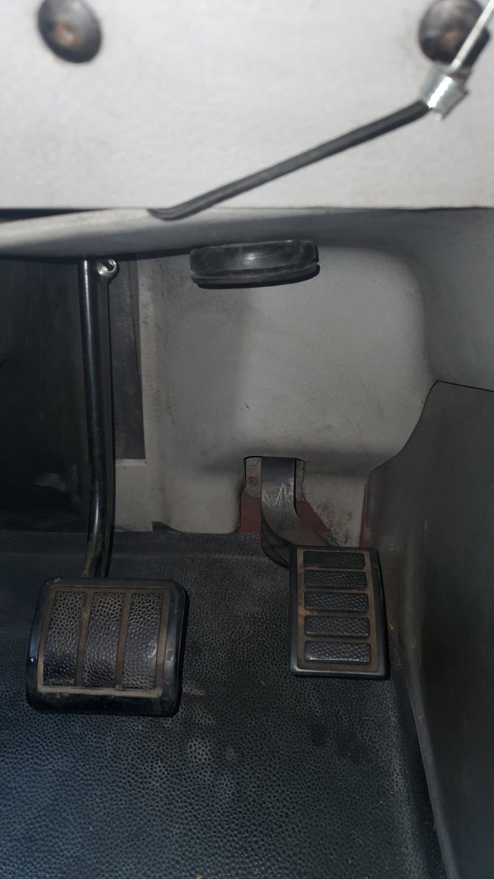

Thank you, this did the job on my 2015 Volvo VNL 780! -
I came here to find out why my cruise control not working and your answer helped me. I lifted brake pedal 1/2 inch and it's working.
Thanks -
how do you raise pedal
With short elastic cord.
