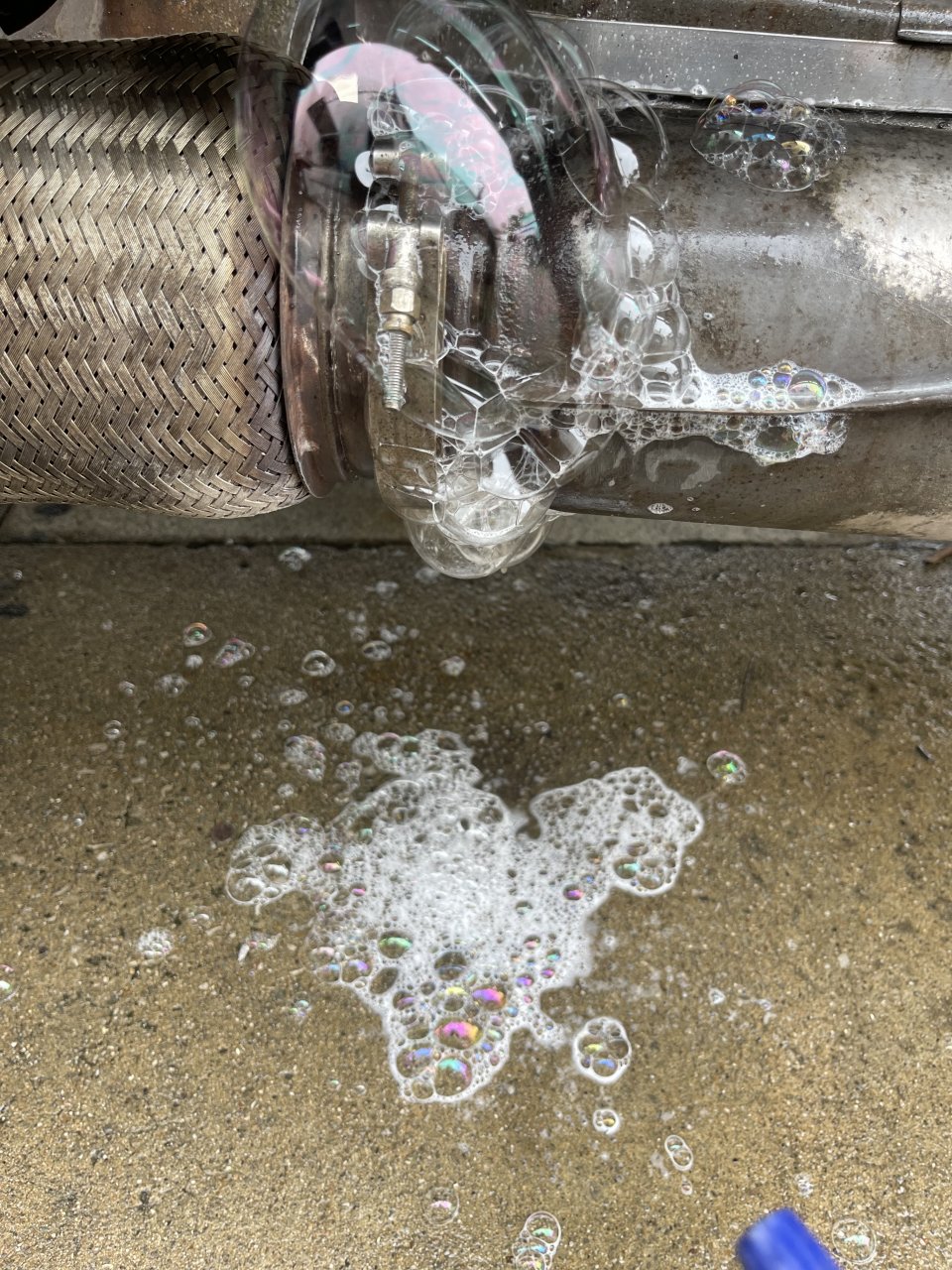

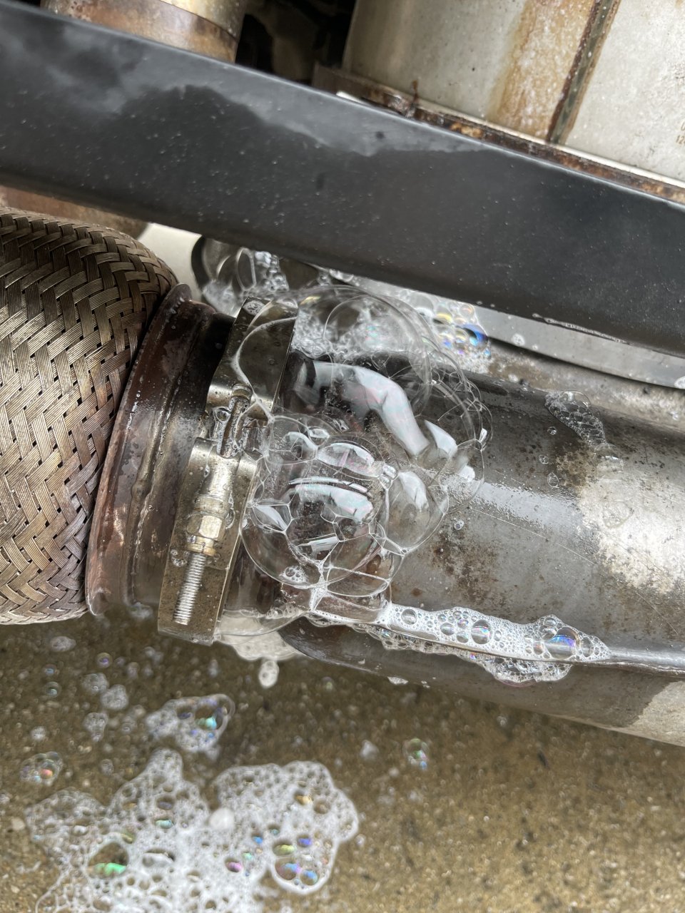

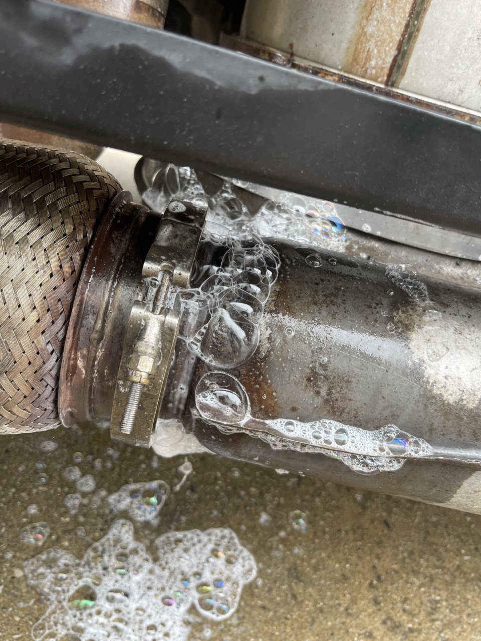

    Good morning fellas,
    I think i found the issue, there is a massive airleak from the holes that i posted above. It is coming from the dpf lower pan. here is pics. Do you guys think i can weld it or maybe get new ?

    Update:
    New flex pipe and weld on the muffler looks like fix the issue. I erase the code using my friends scanner and so far code never came back.
