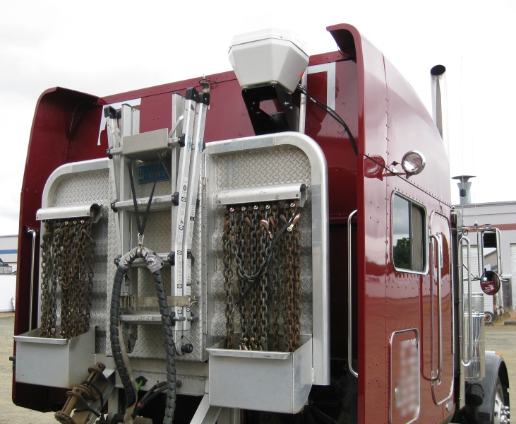

    Mounting: REGARDLESS of which brand or model this is always half the challenge. There are many creative ways. The most common for a V10, V20, or V30 are on the back of the truck as high as you can get it without going over the 13'6" height barrier. The standard mount is a bolt-on mount. Many drivers either don't own their truck or don't want to drill 4 holes in it, so we developed a 3M stick-on mount years ago and it is the most popular for us. In addition there are ways to temporarily mount it to the driver or passenger-side mirror that are well documented on this forum.

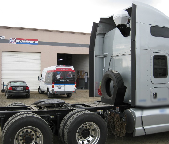

    Here's some pics of various installations that I have done. Every truck is different so each has to be solved on a case-by-case basis.

    If you can leave 4" above the highest point of the truck then it will be able to "see" 360 degrees around the rig in the northern part of the country. If you can leave only 2 or 3" then it will only have trouble up in the northern areas but be fine through the center and southern parts of the country. If you can not leave it at all above the roof then it can see see through fiberglass in many instances as long as there is not a high metal content in your paint.
