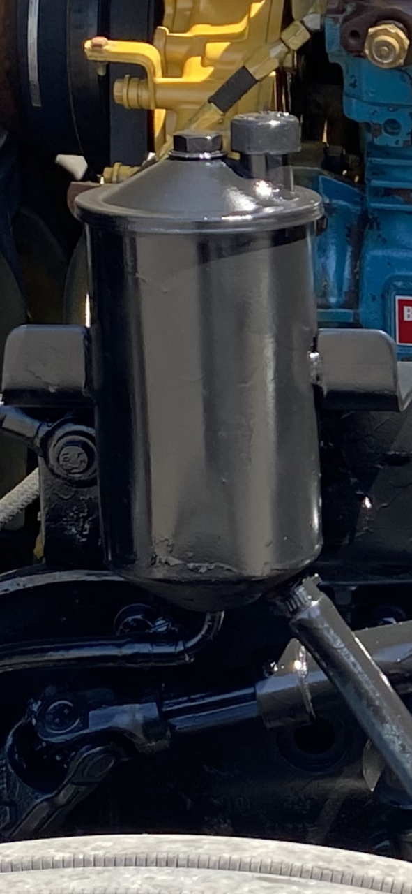

    My 2003 w900 has that old style cone shaped power Steering reservoir and it’s been leaking. So I called kenworth and they said they don’t make them anymore. My plan was to use a newer style plastic reservoir.
    Has anyone upgraded their old style cone shaped power steering reservoir to a newer plastic top reservoir. Let me know if it’s even possible

  4. Adamali21
    Adamali21 Light Load Member
    278
    180
    Jul 24, 2018
    The one I have is allot different then what You have As you can see it’s all welded together and the radiator support mounts to it as well

    Sire it wouldn't be that hard with a little fab work. Or just find a good used one from the salvage yard
  7. Rideandrepair
    17,320
    56,197
    Aug 8, 2015
    Same thing. Different mounting bracket. There’s a bunch of different bracket types. You could grind the old one off, leave the bracket. Drill 4 holes and mount one of these. Could also have it tack welded. Could have yours patched if leaking. Doesn’t look rusty. Where’s the leak? Lots of choices available. New about $200, used $100 on average.

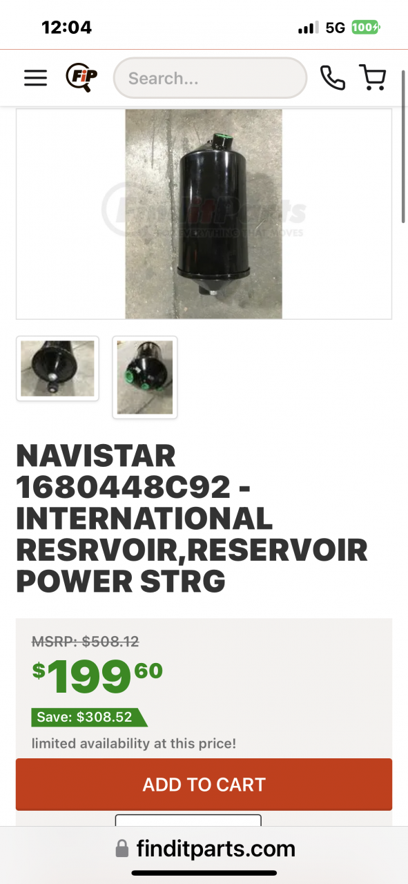

  8. Adamali21
    278
    180
    Jul 24, 2018
    We cut the old bracket drilled 2 holes and installed this reservoir that I bought from raneys
    $200 dollar fix cleaner and at least I can see the fluid
    Oxbow and Rideandrepair Thank this.
  9. Adamali21
    278
    180
    Jul 24, 2018
    Before and after
