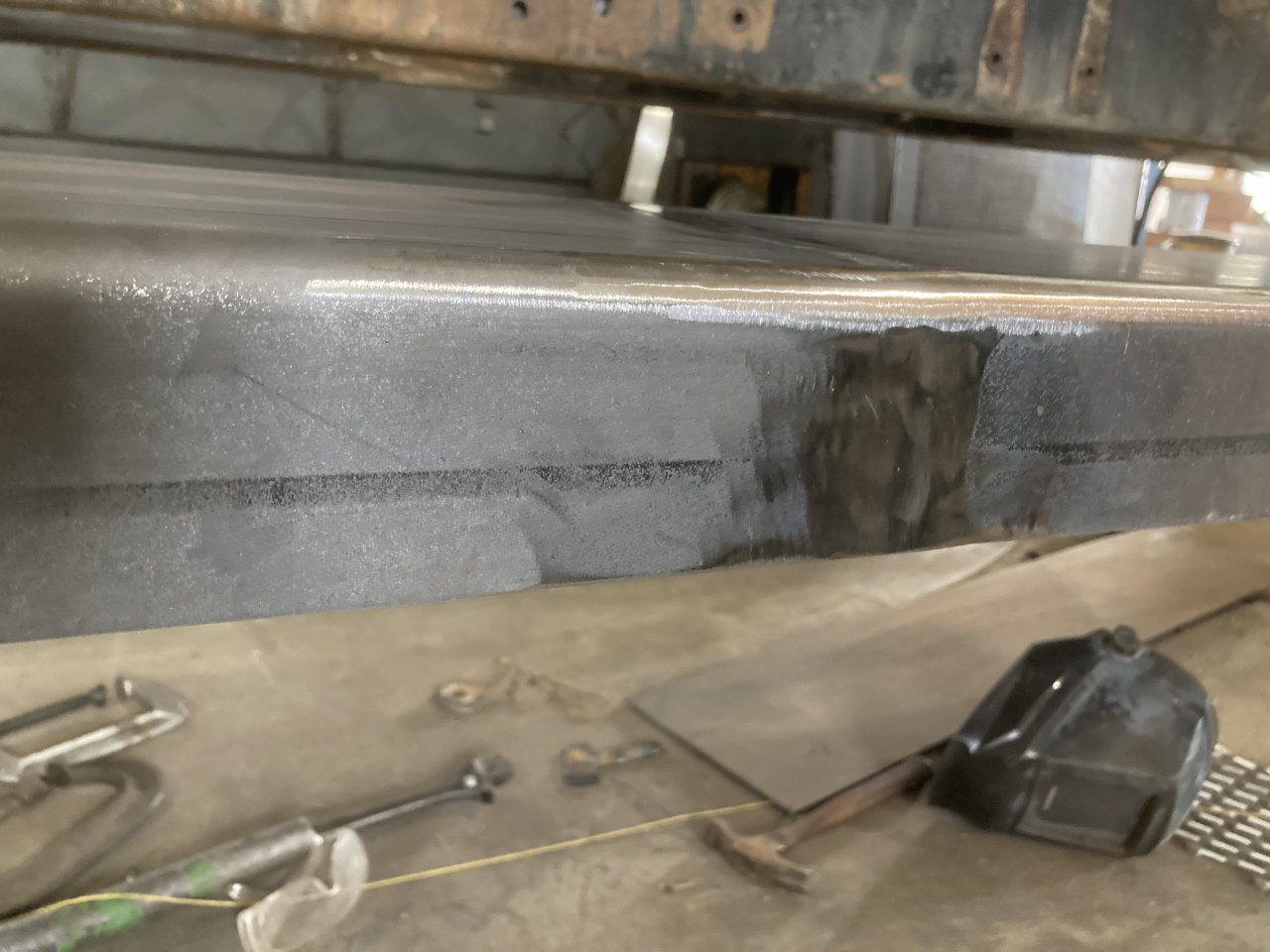

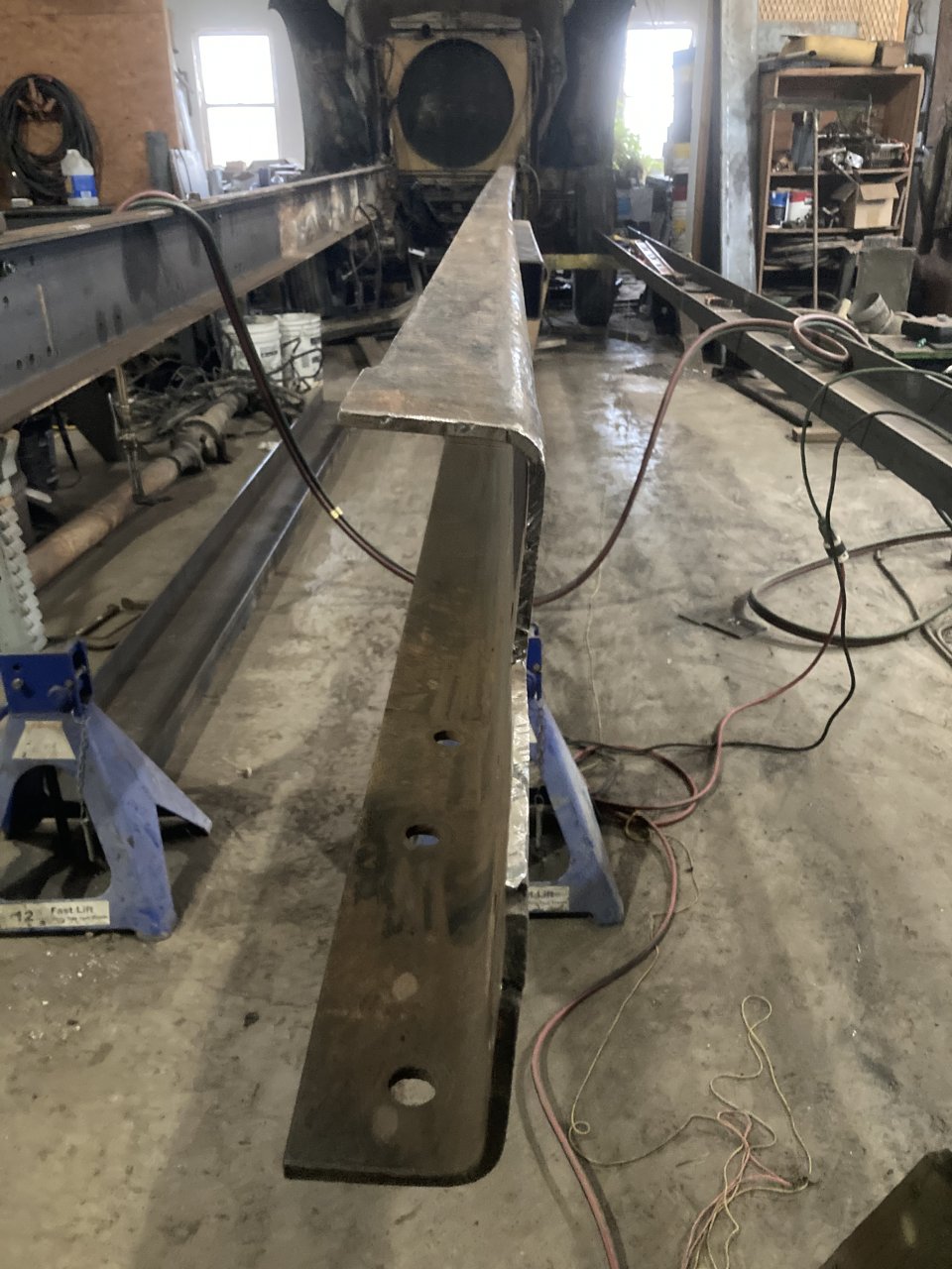

    I finished stripping the obstacles off the frame and noticed that the right side rail was bent about 1.5 inches in the weak axis so I straightened it 2C7C423E-3290-400A-AA2D-AC56B15211F2.jpeg
    now it’s less than 1/16
    I know it looks twisted to but that’s because of how it’s sitting in the saddle of the jack stand.

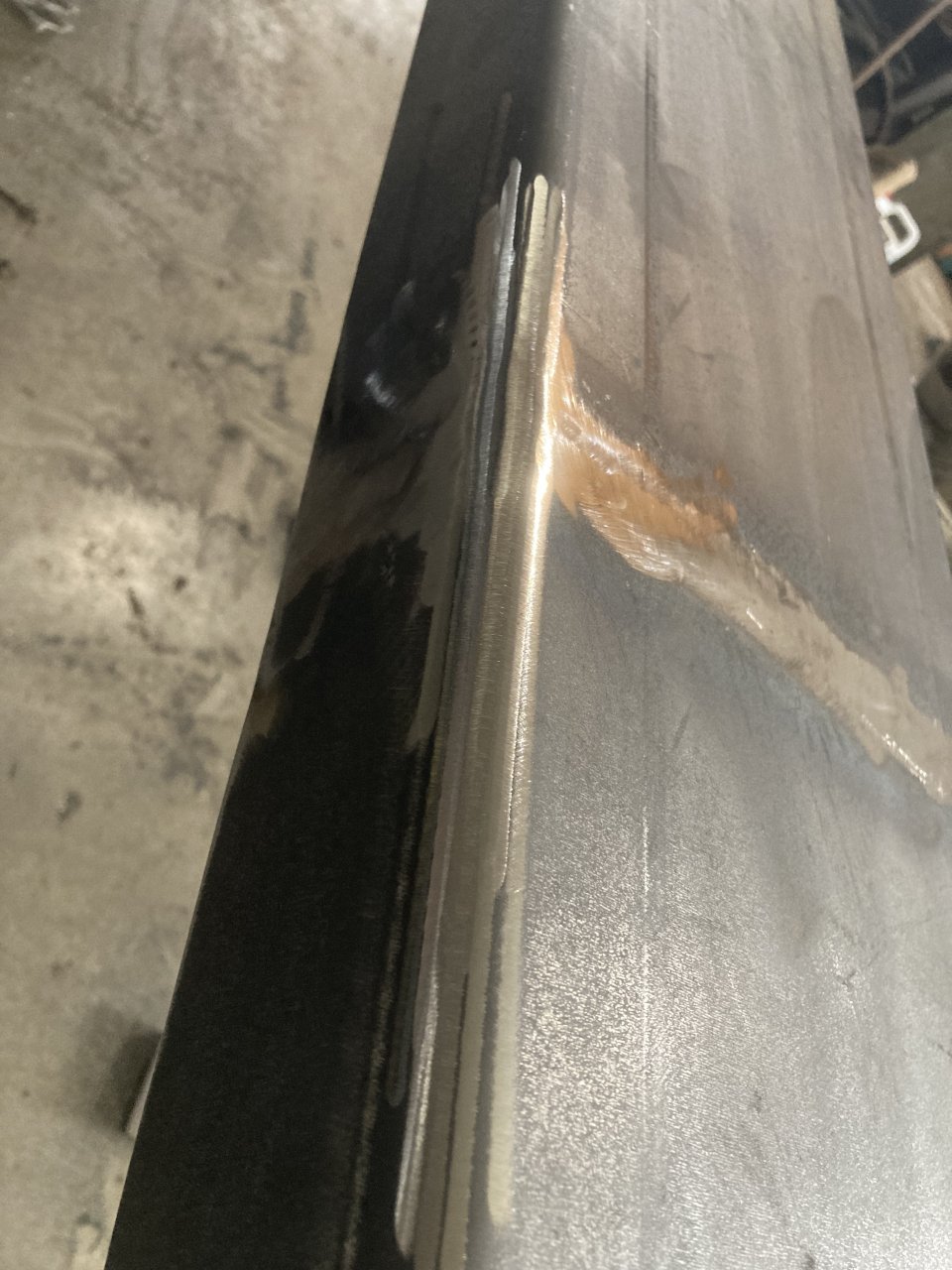

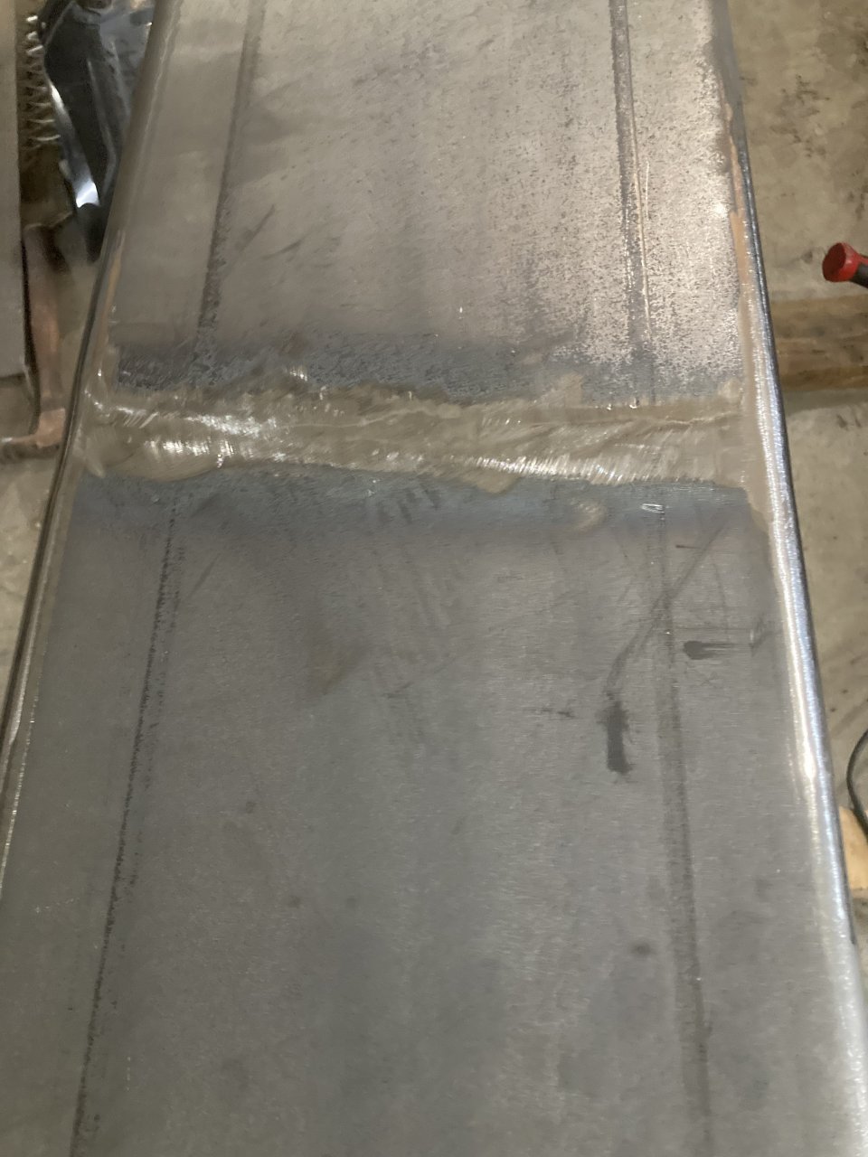

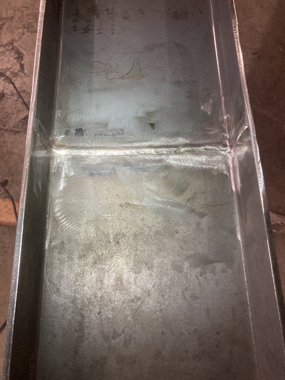

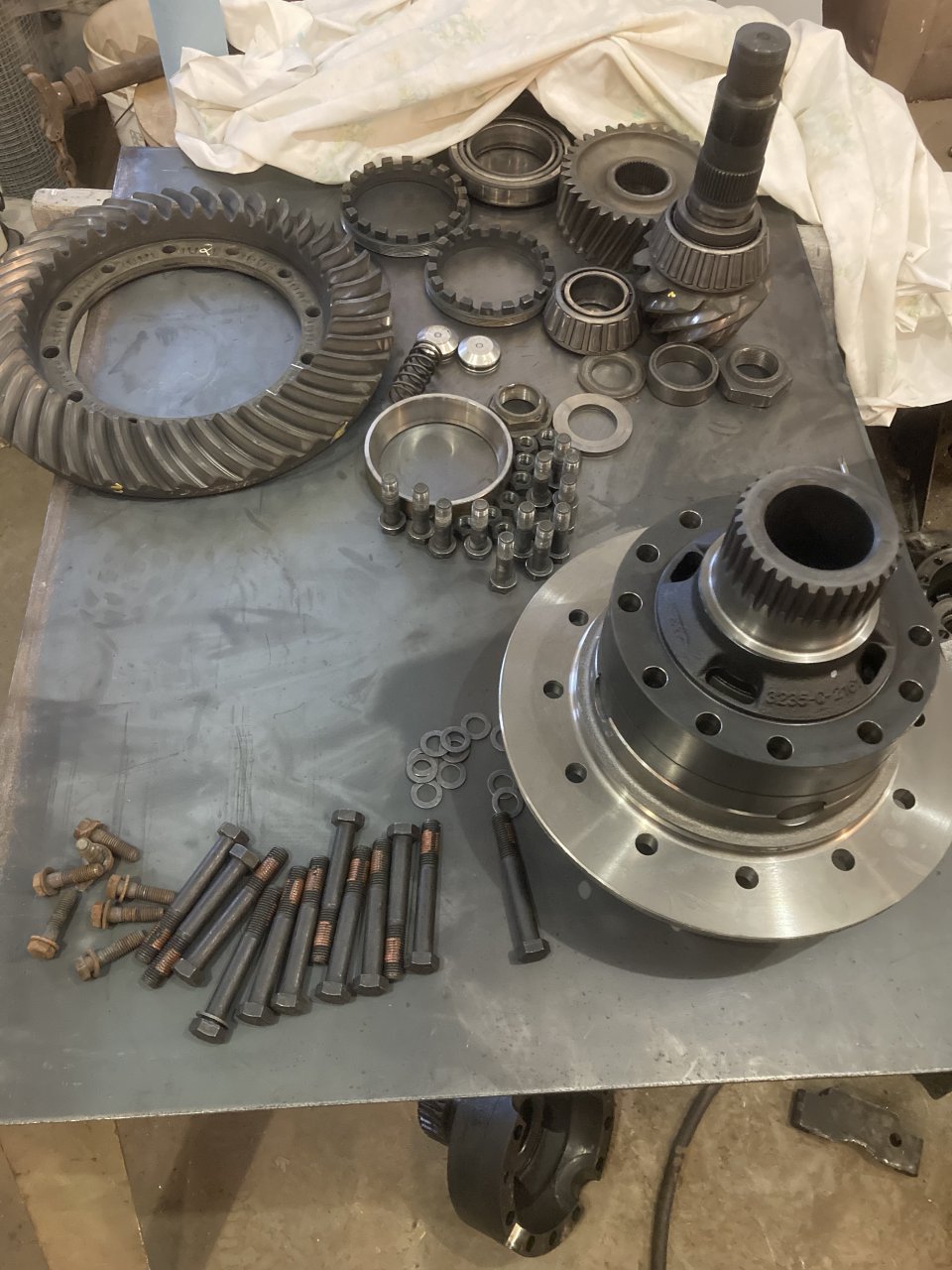

    62575A79-6420-49C6-9C21-915DFEF5362E.jpeg EA7D4F85-519C-40D6-8AD3-1BDC3222E900.jpeg 71A489F1-0556-40F2-A2AF-2AE7F2EA116F.jpeg
    and I got my rear diff all rebuilt/ put back together.
    The power divider is dissembled and some are clean…still have some for tomorrow and need a couple bearings before I can reassemble

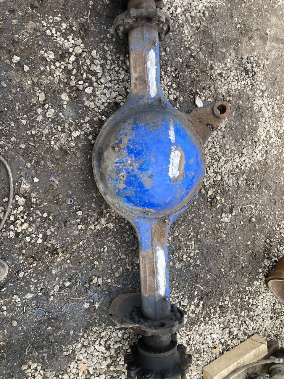

    982BC851-1ACC-4306-B33E-2A73003C3E55.jpeg 46k axles are really common with walking beam suspension and can be had cheap but since we’re using airliner on this truck I had to get rid of the extra brackets. 4154AA10-D321-492E-BBC0-EEC2765B6128.jpeg
    All of the rough ride components are gone except the transverse torque arm mount which is pretty close to the freightliner setup except about twice as stout so I am going to use it instead 283A7E96-EEEB-4752-8617-56304A3745A2.jpeg got the housing all cleaned out and dropped the rebuild diff in for storage so I can do the front one…I only have one stand setup to hold them.
