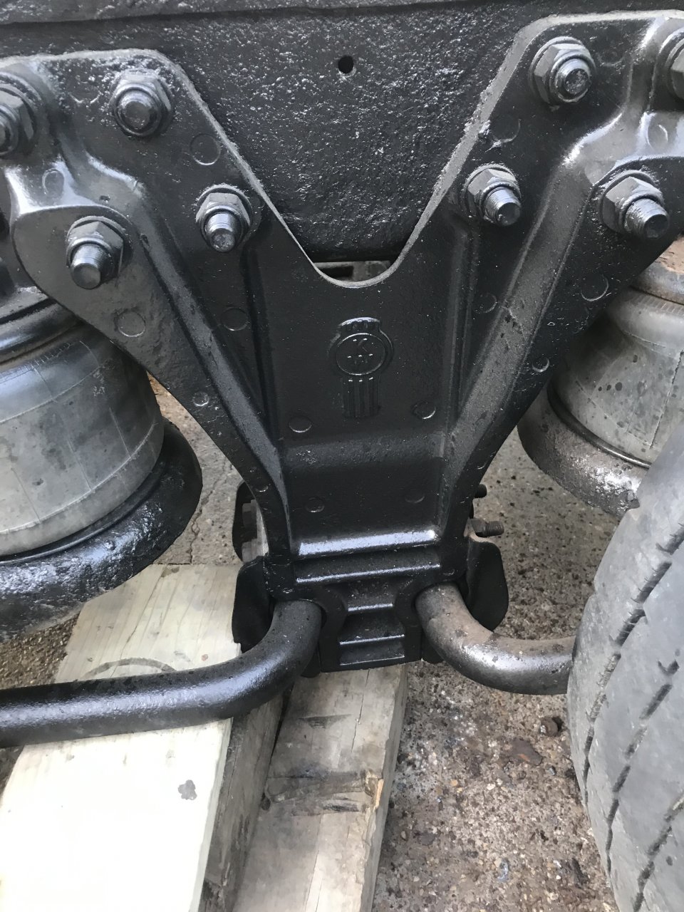

    E6791A89-FFD8-4EFA-A194-F82C1813BF5D.jpeg 0854FE16-9E69-416B-B78E-B9E4179B126C.jpeg 93 model with what I believe is the AG 100 system. Needing to replace a couple bags and here’s what the suspension looks like. Y’all got a part number for the bags I need?

    Tag picture of top bag mount. I have 8 brand new ones for sale.

    Probably need the new larger 90 degree supply lines to go with them when you order.

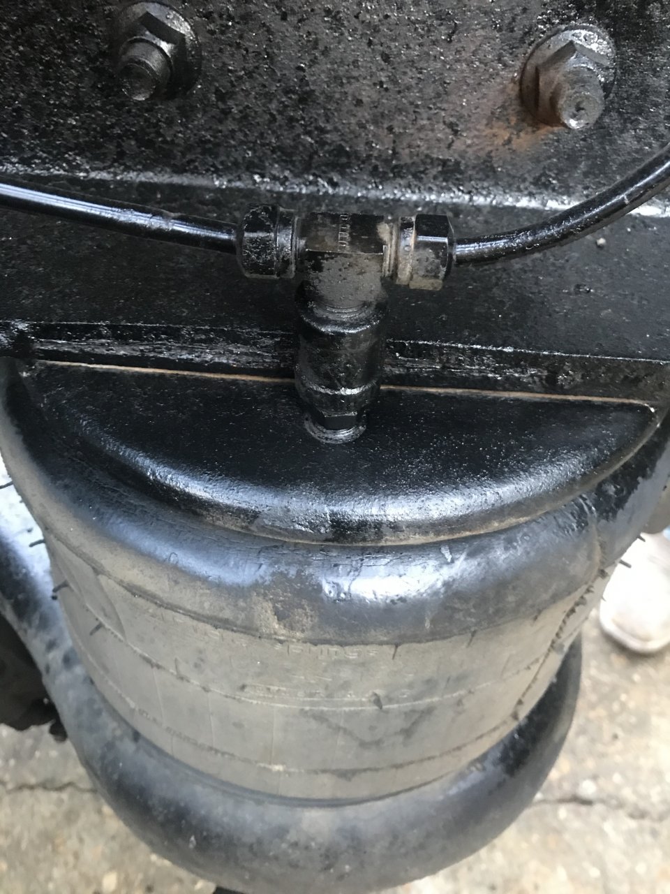

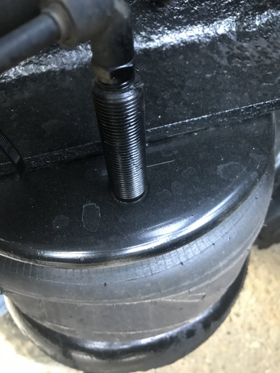

    1563C163-466B-4D7B-B8E2-B5A92D94266D.jpeg 5C8F2476-BB59-447A-BD4D-26B85F6F12CD.jpeg The bags on the left side have the small supply and all the bags on the left have the larger supply. My B model has the aluminum bracket that attaches the top of the bag to the frame but this “L” model uses the steel 90* bracket.

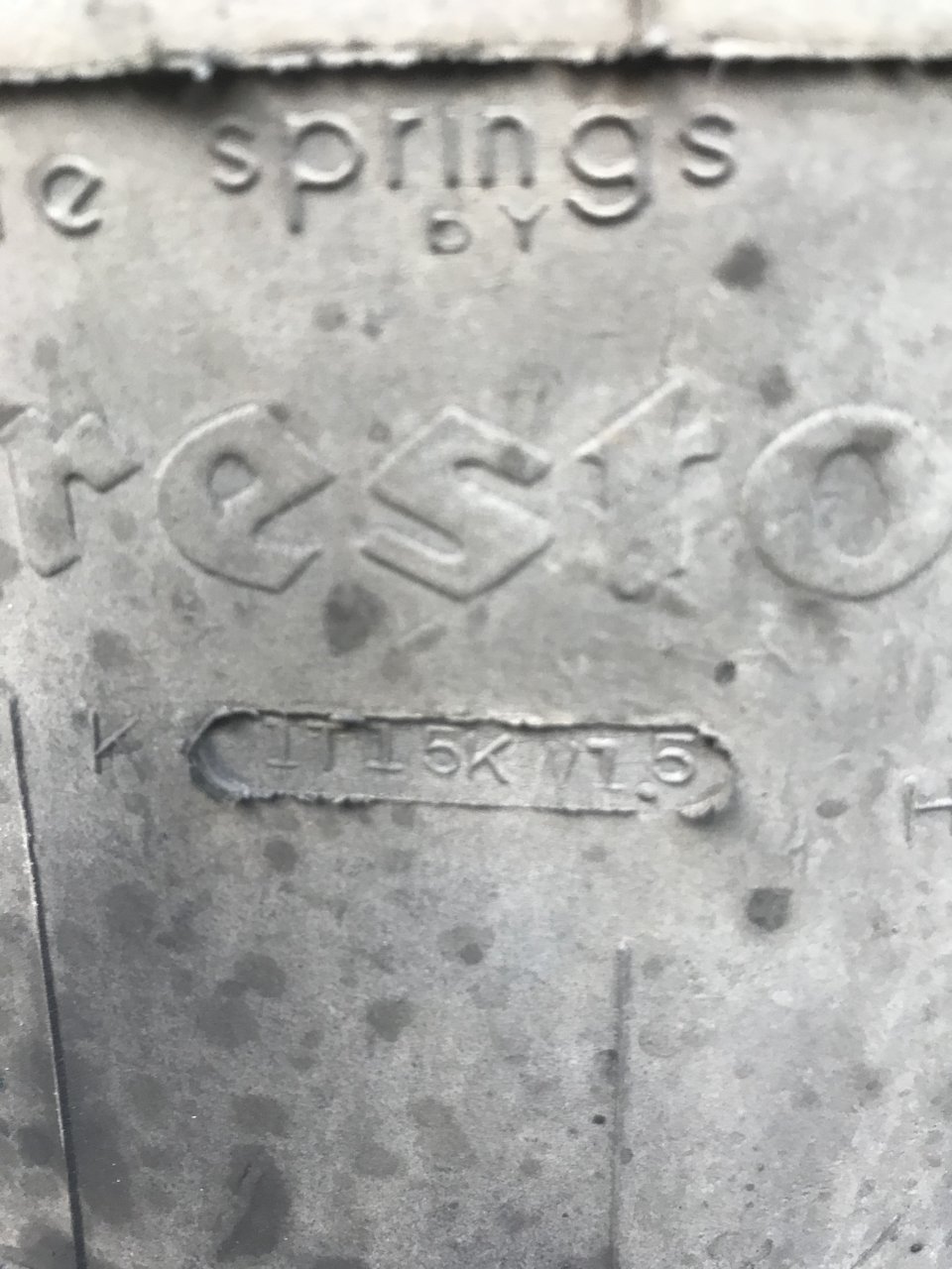

    The AG100 changed the air bag around 94. Earlier ones used the W01-358-9422. Had aluminum spacer and 3/4 stud. The later ones use the W01-358-9616 (K303-16) that uses 3/8 stud and stamped steel bracket.
