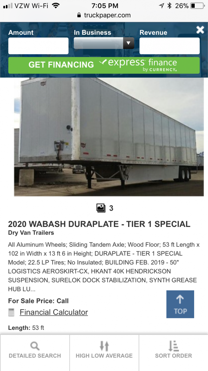

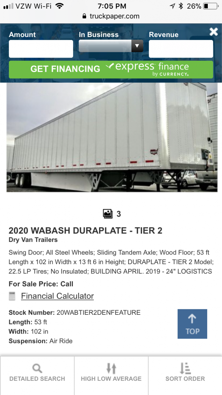

    Whats the difference between a Wabash tier 1 and a tier 2 dry van....?
    CEF20B7E-D25A-4849-8822-9039A55E751E.png BCC174A0-9BFE-41F2-A381-7A748EC8511F.png
    The specs look the same on the info sheet.
    P.S. Asking for a friend.....:-/

    From the looks maybe tier 2 is heavier spec? Look close at the side walls. Rivits are closer together

    Logistics posts on the tier 1 are at 50” and the tier 2 at 24”
    slow.rider, Leopard, KB3MMX and 4 others Thank this.

    Yes, depending on what you or your “friend” plan to haul would depend on which trailer you’d want to buy. The trailer with 50” post spacing will weigh less and be cheaper, all other specs being the same.

    Tier 1 has aluminum wheels, tier 2 has steel
