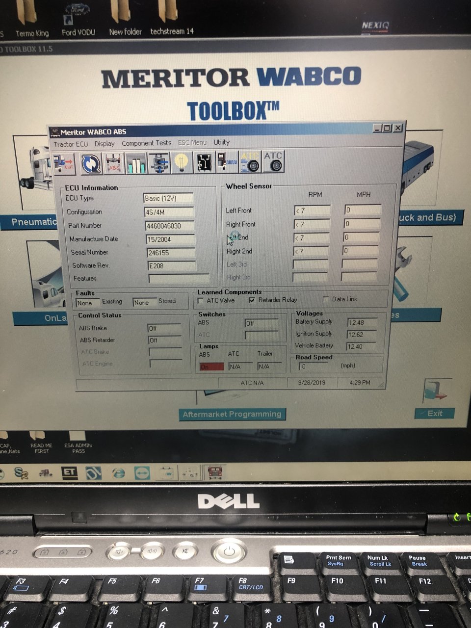

    Abs lamp on but no fault codes as in attached picture. 2004 KW T2000
    Any ideas?

    could be bad module.

    Can I force it to turn off from the software ?

    Brother you have the software not me. try it. maybe you can force it off. do it, don't worry.

    Did you recently work on it or clear previous codes? If so, it needs to reset itself by you simply driving it over 5 mph so the system can see wheel speeds on all sensors. Then the light should go out.

    The light has been on for a couple months now but owner wants it fixed now

    Strange state for it to be in all the this time. Road test it and watch for all 4 wheel speeds to be the same and make sure road speed at the bottom is accurate too.

    Wheel bearing wobble?? Bad sensor.

    There are codes for those that should get logged.
