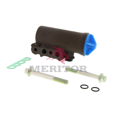

    Governor just controls cut out/cut in. When it hits cut out, it sends air pressure to the unloader piston, which opens a valve in the compressor head to keep it from making pressure. At cut in, it vents off the air from the unloader, so the compressor can start building pressure.
    Governor looks like this and is usually mounted to the compressor or air dryer.

    If there's no air in the system, the governor cannot unload the compressor. If you have 0psi, and it won't build, either the compressor isn't turning, or something inside the compressor is causing the issue (possibly stuck unloader). Ice in a line will either cause the compressor safety relief or dryer safety relief valve to blow, depending on where the blockage is.
    If you want to eliminate the governor, you could either unbolt it from the compressor, or if mounted on the dryer or remotely, just pull the small unloader signal hose from the compressor.

    On the governor, you can pop the plastic cap off, loosen the jam nut then turn the threaded rod the center with a flathead screwdriver left or right to change when it cuts in and out to test it.
