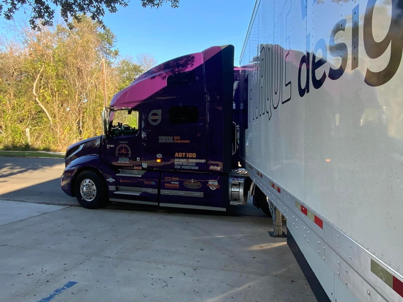

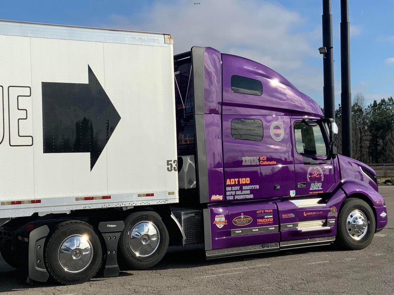

    Joel runs the tightest I’ve seen and doesn’t slide the 5th wheel. He just pays attention to what he’s doing.
