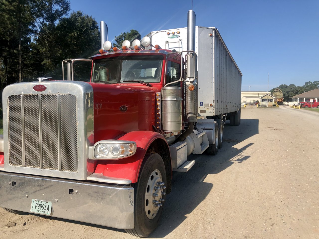

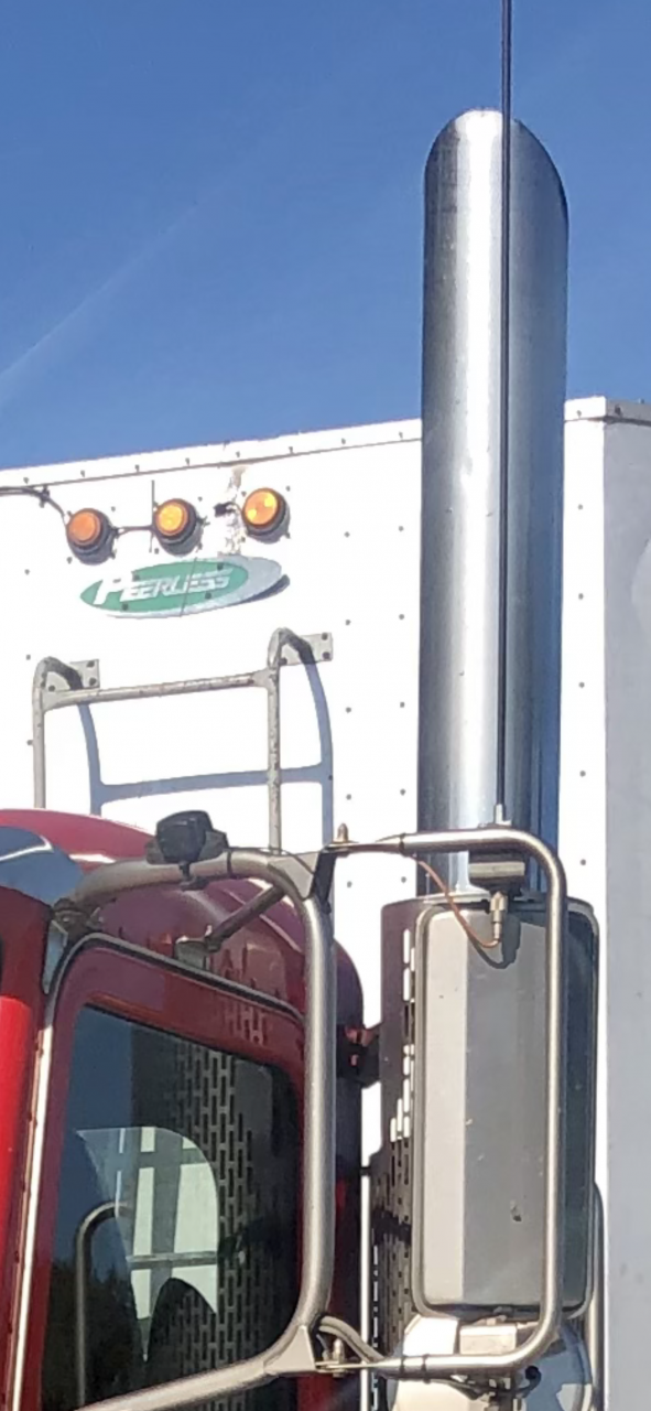

    I appreciate the feedback guys, I see my biggest focus needs to be in the antenna set up. Here is a few pictures of the current set up, what advice do you have on it?
    wanted to get a new antenna and possible coax, skip shooter has been mentioned and from reviews and the price looks good.
    Is the mirror enough of a ground or do I need to give some attention there also?
    Again, I appreciate the input, means a lot!

    As far as the antenna, I would go with a 5' Skipshooter.
    https://www.amazon.com/Skipshooter-...Q2Z9HR&qid=1631467641&s=merchant-items&sr=1-2
    Coax, don't cheap out! I like this.
    https://www.dxengineering.com/parts/dxe-8xdx015
    Different lengths are available depended on your needs.
    You might consider a new antenna mount, but at the very least, clean the connections on the mount you have.

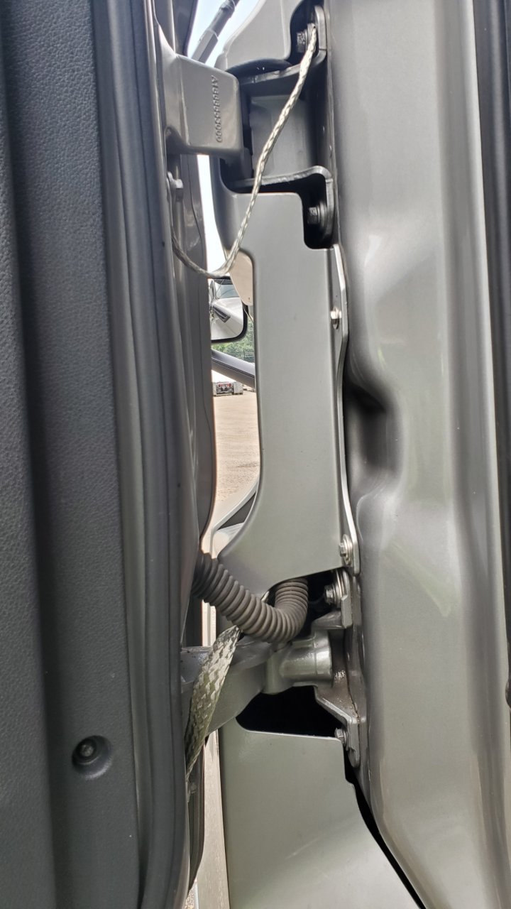

    You probably have a decent enough RF ground, but it might not hurt to ground the door to the cab.
    Kinda like I did on the Freightshaker I drive. Flat braided ground strap only!!!!!
    You will also benefit from wiring the radio power directly to the batteries with at least 8-10 AWG wire. The radio will work off the power posts in the truck, but not at it's best.
    This all might sound like alot of headache but big radios aren't plug and play if you want the performance that you paid for.
    Good luck!
    JD
