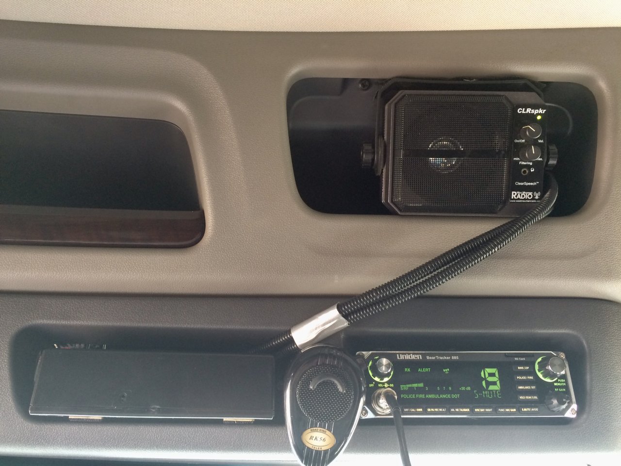

    This is the setup in my 2016 Peterbilt 579. Cousin to your KW
    A GPS locator and the Uniden 885 Hybrid CB/Scanner are on lower level. The West Mountain DSP ClrSpkr is above (with power and audio cables shown).
    The speaker has two controls:
    1) Volume
    2) Filtration Amount
    Digital Signal Processing might mean that some “sound” isn’t ever human speech. So it cuts that off.
    On the sound that is closer to speech it modifies along a curve. The greater the Filtration the more that speech “naturalness” is stretched
    Overall, some extraneous sounds still come through. What you’ll find interesting is that there are conversations that were hidden behind noise you can now follow.
    Some of those are distant enough you may not be able to reach them with a great rig install (though it isn’t skip).
    Overall, nothing makes as much of a difference given that we are working with factory coax, power leads and antenna.
    Change power (and filter), change coax (and cut CMC) and a better antenna mount plus antenna (tuned) you’ll STILL choose to use a DSP speaker. They really are that good.
    If the best possible pair of ears is a priority, you won’t want your money back.
    Now, as with any length of wire, the power/audio cables may act as an antenna. Same problem as the rest of the rig. Ferrites as beads or toroids are recommended

    I’ve got close to 200k miles on the speaker.
    Takes a little time to dial in (not in order):
    A). Mike Gain
    B) Talkback
    C) Speaker Volume
    D) Filtration
    E) Squelch
    F) RF Gain
    The speaker is sensitive as to feedback. Location will matter. (Mine will eventually move). Same for using a power mike.
    Getting feedback from another radio operator is useful with any rig as to transmit audio quality. With this speaker it sets a baseline to dial in the other controls. I ran across OKC not long ago at something of a right angle to some base operators who helped me set that baseline. .
    Now, if I change Gain or Squelch the other controls stay constant.
    The amount of Filtration (think of it as modification) may not seem to change much from Low to High. I usually have it set something less than half the full range.
    Nothing else will do as much to improve the usefulness of a given transceiver.
