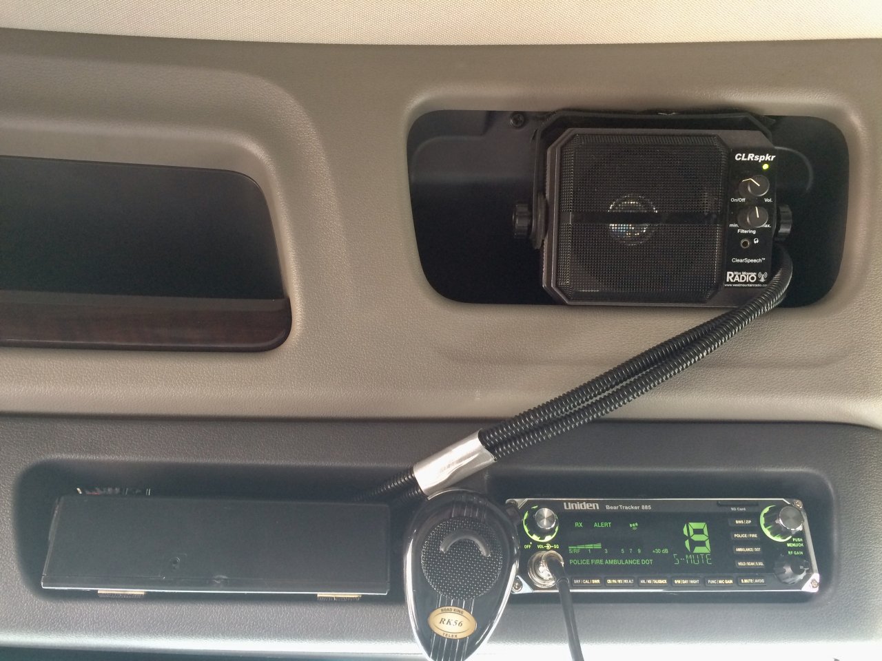

    That’s in the 579. In a new KW 880 I was running last year I’ll admit to not remembering (three trucks ago).
    Power is 12V. I run everything off the supplied 15A binding post pair:
    1). Uniden 885
    2). 100W RM Italy KL203 amp
    3). West Mountain Radio DSP Speaker
    Timin770 Thanks this.

  9. Slowmover1
    Slowmover1 Road Train Member
    1,491
    1,209
    Oct 25, 2015
    Fort Worth
    I got carried away in a post on www.wwdx.com in the CB section in re DSP speakers. The rest of the thread you’ll find informative.

  11. Slowmover1
    1,491
    1,209
    Oct 25, 2015
    Fort Worth
    I had Rays CB install heavier gauge power leads to the KL203. And a quick disconnect.
    All three devices powered from same line. Spliced together.
    I used a HD Wilson power cord from truckstop, with soldered tips to fit binding posts. Splice is behind fuse.
