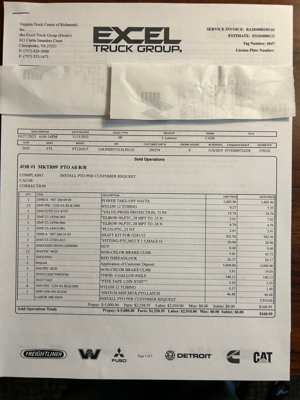

    Do you have all the information? Im trying to put a wet kit on my 2019 cascadia bought from excel also down in SC
  4. KDHCryo
    KDHCryo Medium Load Member
    568
    824
    Sep 14, 2023
    Here' my invoice...the DTNA parts you need are listed on the left. That'll give the dealership a start.
    Hammer166 and Cat sdp Thank this.
  5. Tyronedee55
    Tyronedee55 Bobtail Member
    11
    2
    Jan 22, 2023
    I appreciate your help so after they installed that whats next?

    In my case a hydraulic 60gpm pump mounted to the transmission, that feeds an air compressor or a blackmer liquid pump. Your application depends on what you need the pto to do.
