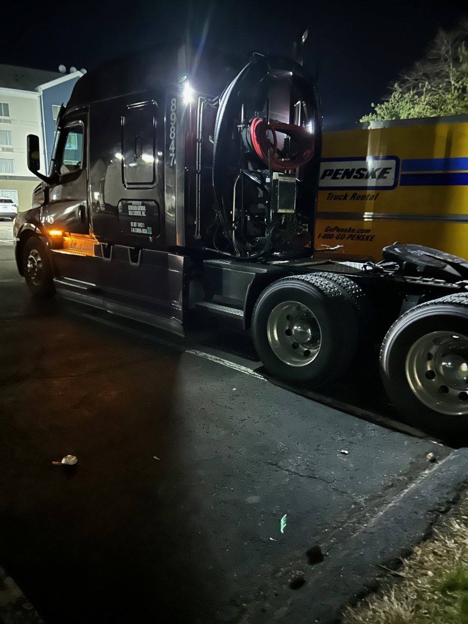

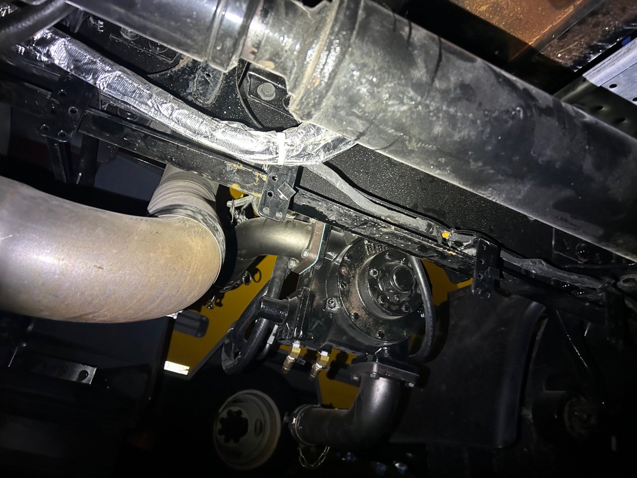

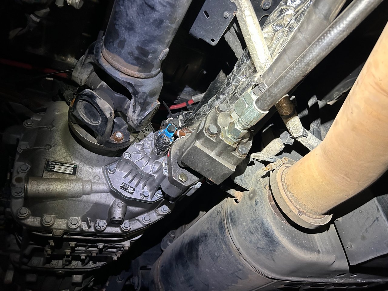

    Anyways, this is a DT-12 to 60 GPM Hydraulic pump feeding either /or Ingersoll Rand Air compressor, or a Blackmeer Liquid Pump.

    Have you used your setup yet ? Is it working properly?

    Where is the wiring harness for the pto or did you have to purchase separately

    Works pretty good...have dumped a smooth bore (5000 gallons of adhesive ) through 80 ft of 3 inch hose in about 45 minutes
    Wiring harness is factory freightliner, built into the DT12 harness, one standard freightliner switch on the dash.

    My truck doesn’t have a switch in the dash. I looked underneath the truck around the tranny to see a harness with plugs but no luck
