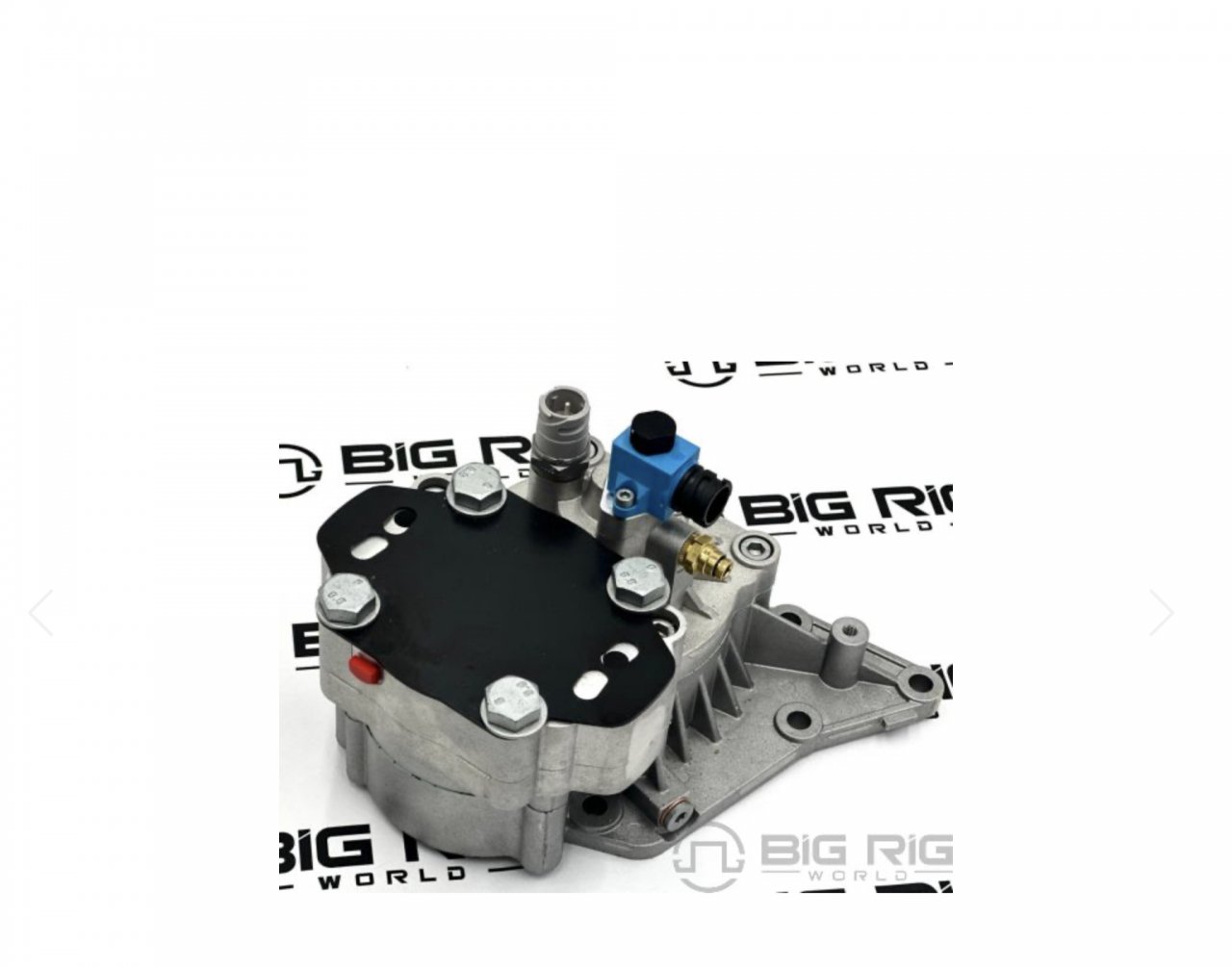

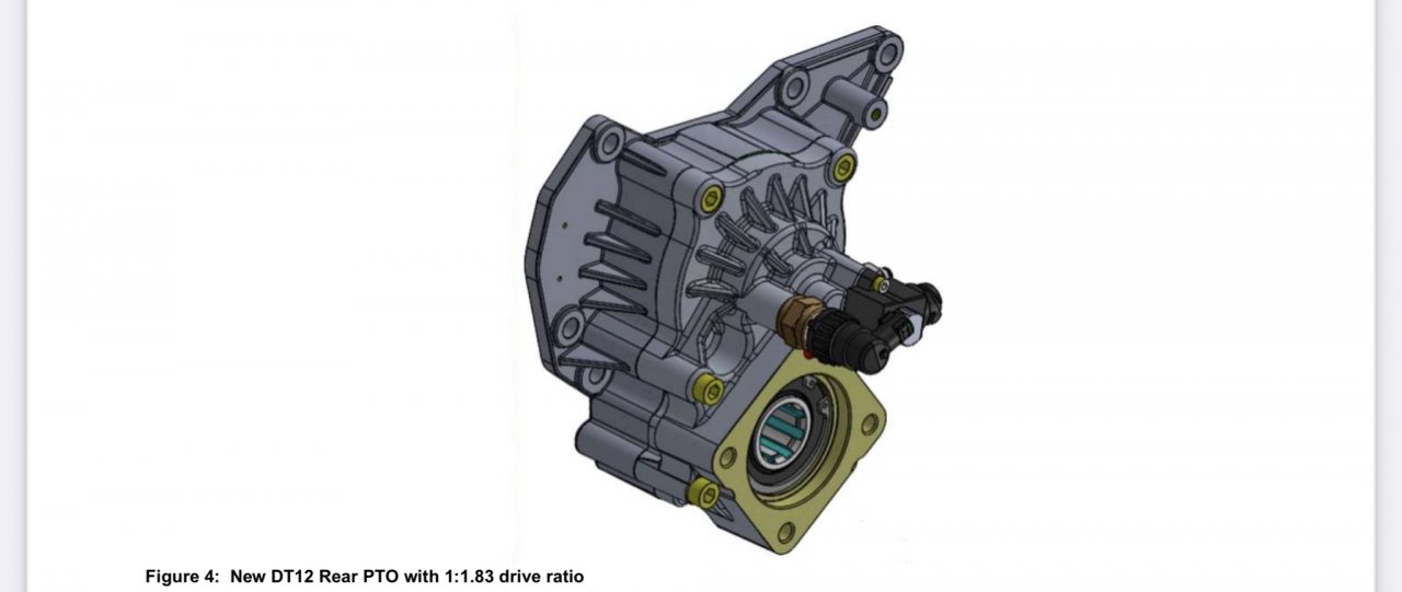

    I’m installing a rear mount Detroit pto pump on a DT12-DA transmission,and I can’t seems to figure out the wiring. Has anyone installed one on there truck or have a diagram of the wire harness? Any help would be appreciated. 457DFE05-0913-491A-9EED-7275533FA866.jpeg 5F2C29F7-097F-4011-887C-33B51D2EC5EA.jpeg
  8. Tyronedee55
    Tyronedee55 Bobtail Member
    11
    2
    Jan 22, 2023
    Freightliner dealership install all parts and harnesses. What year is your truck? If its 2017 or older it will need modifications
    Marcuskc Thanks this.
  9. KDHCryo
    KDHCryo Medium Load Member
    568
    824
    Sep 14, 2023
    Take it to the dealer, or at least call the dealer. The trucks software will need to be changed by the dealer so that the body ECM knows the PTO is installed which requires a full license and programming event in Diagnosticlink.
    Not just a simple matter of bolting on parts and wiring in an on/off switch.
    Marcuskc and JB7 Thank this.
