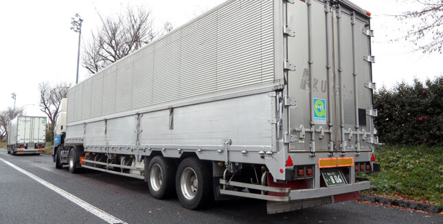

    There should be some kinda low hanging bar kinda like the bumper on the back of a trailer. Something that would not allow a car to go under the trailer.
    Could of avoided all kinds of damage.
    Were the side skirts hang you could install a bar behind the wind apron. Im surprised the industry doesn't already do that.
    Wouldn't of prevented this accident. But could of prevented being totaled.

    Europe has had them for ages. I have seen them installed on some fuel tankers for a few years. Boston now requires them on city and contracted trucks.

    I wouldn't want something rigid like that. I've been quite a few places where even those aerodynamic side skirts would get ripped off due to their inability to clear objects and the terrain. If people would get their heads out of their hind end and pay attention to what they are doing, stuff like this wouldn't happen. If the truck driver knew how to drive, that wouldn't have happened. If the 4-wheeler had realized that the truck driver was an incompetent idiot, they probably would have avoided pulling up there, too...but we're all SUPPOSED to be "professionals"...which implies a certain skill and proficiency at our trade. The only thing the car driver did wrong was to assume the truck driver was competent at his job.
