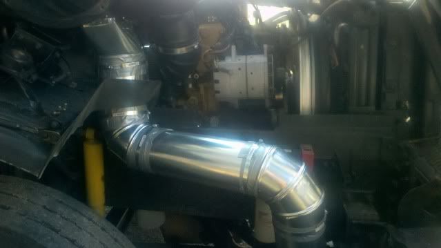

    Bought my Fleet Air Filter from them at the MATS 2011 Truck Show that I changed it out in the parking lot in my 1998 Volvo 770. I immediately could tell a difference with throttle response and could hear the turbo spool up easier too. My fuel mileage on my dedicated runs picked up 3/10ths to 4/10ths MPG.
    I highly recommend washing it every quarter (3 months) as they recommend and oil with Klotz filter oil to keep it in top shape.
    Well worth it on an aero truck with an underhood filter box and especially with 400+ hp. The more HP, the more critical the filter is to keeping with the air needed thru a single filter box that is designed for motors under 400 hp.
    I even recommend adding more ductwork to get that filter box more air...
