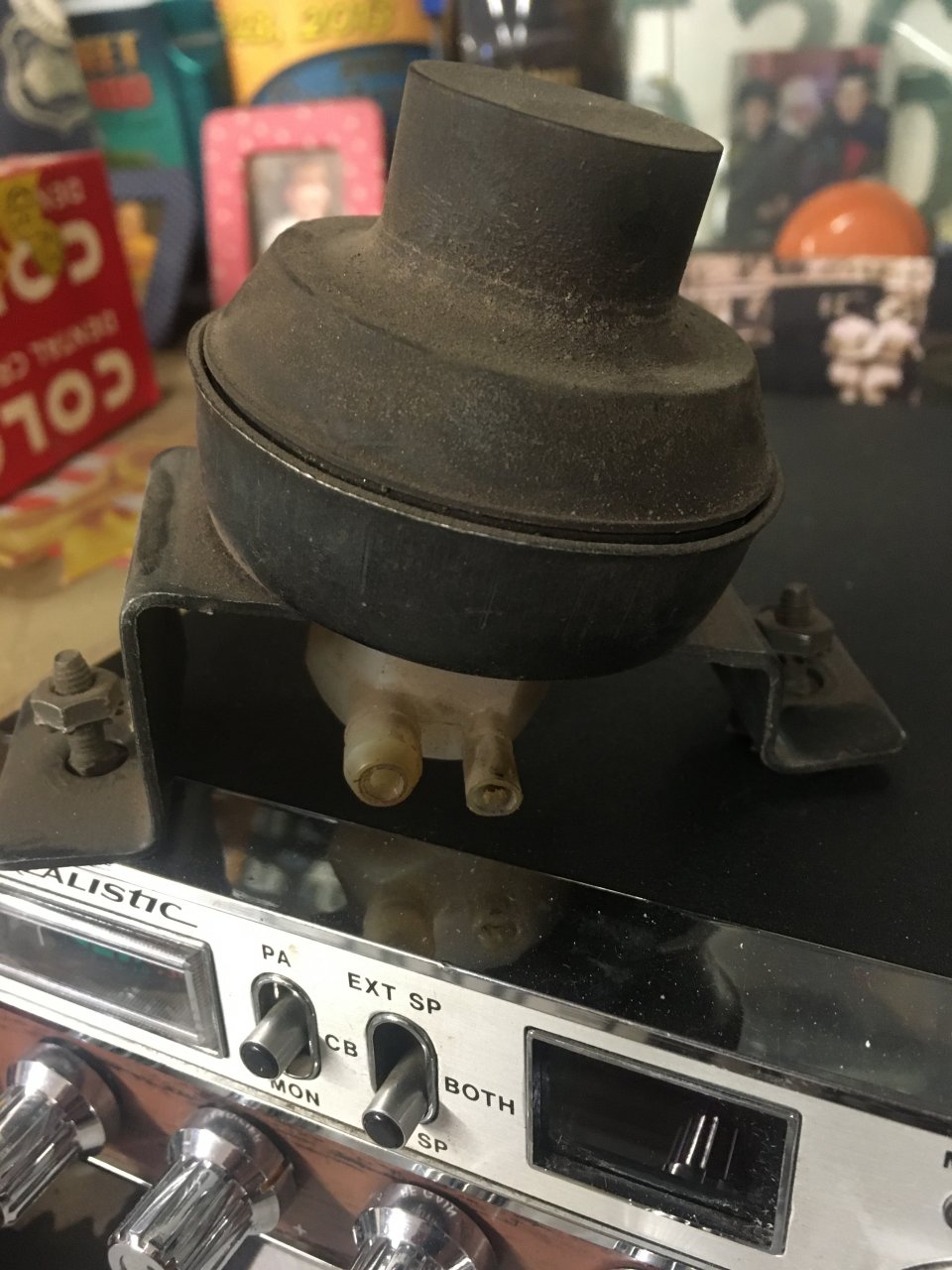

Old school solution to those problematic electric pumps
