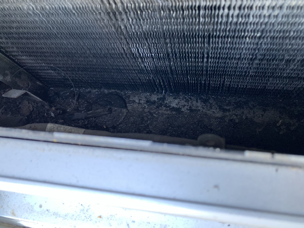

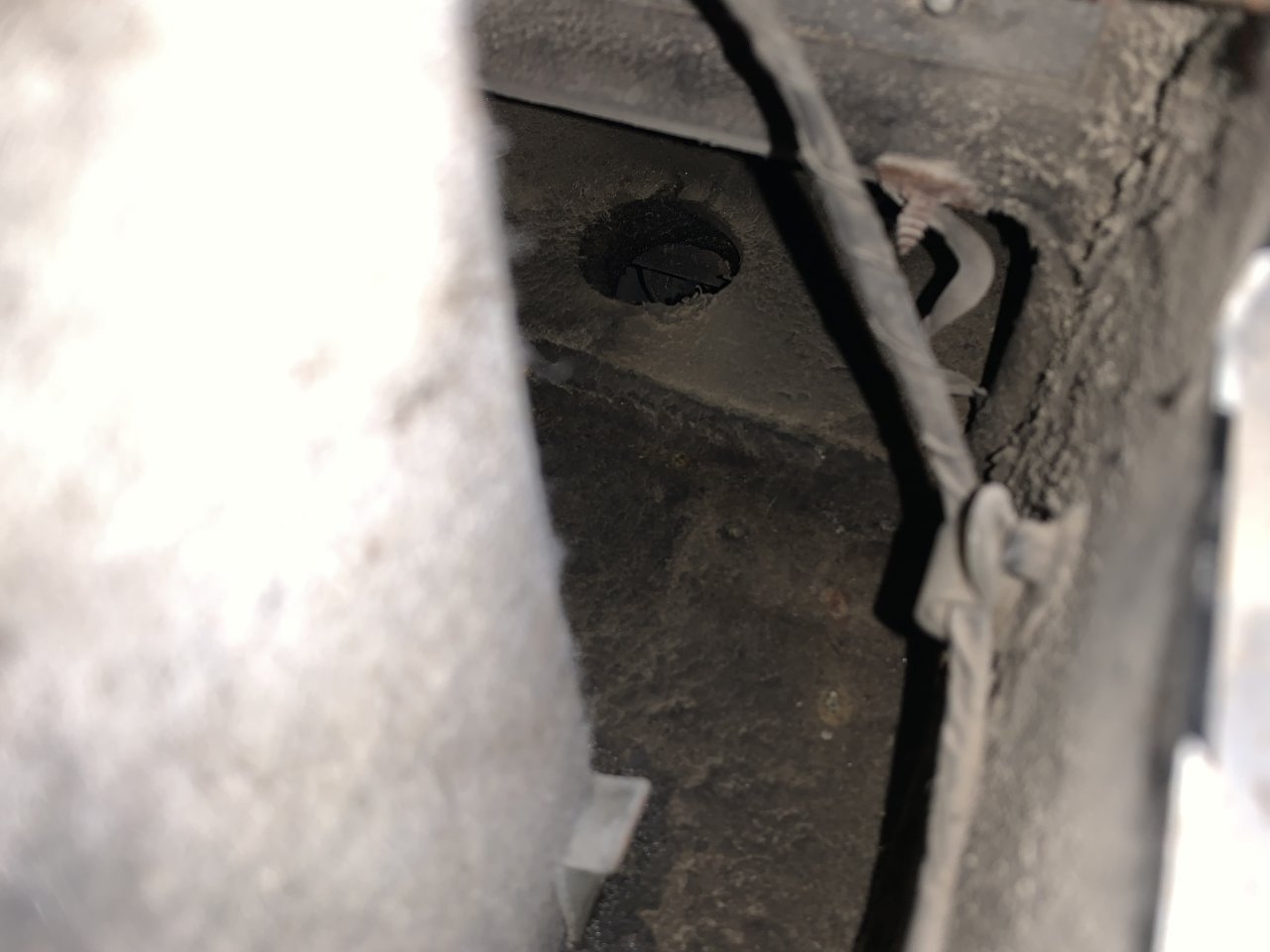

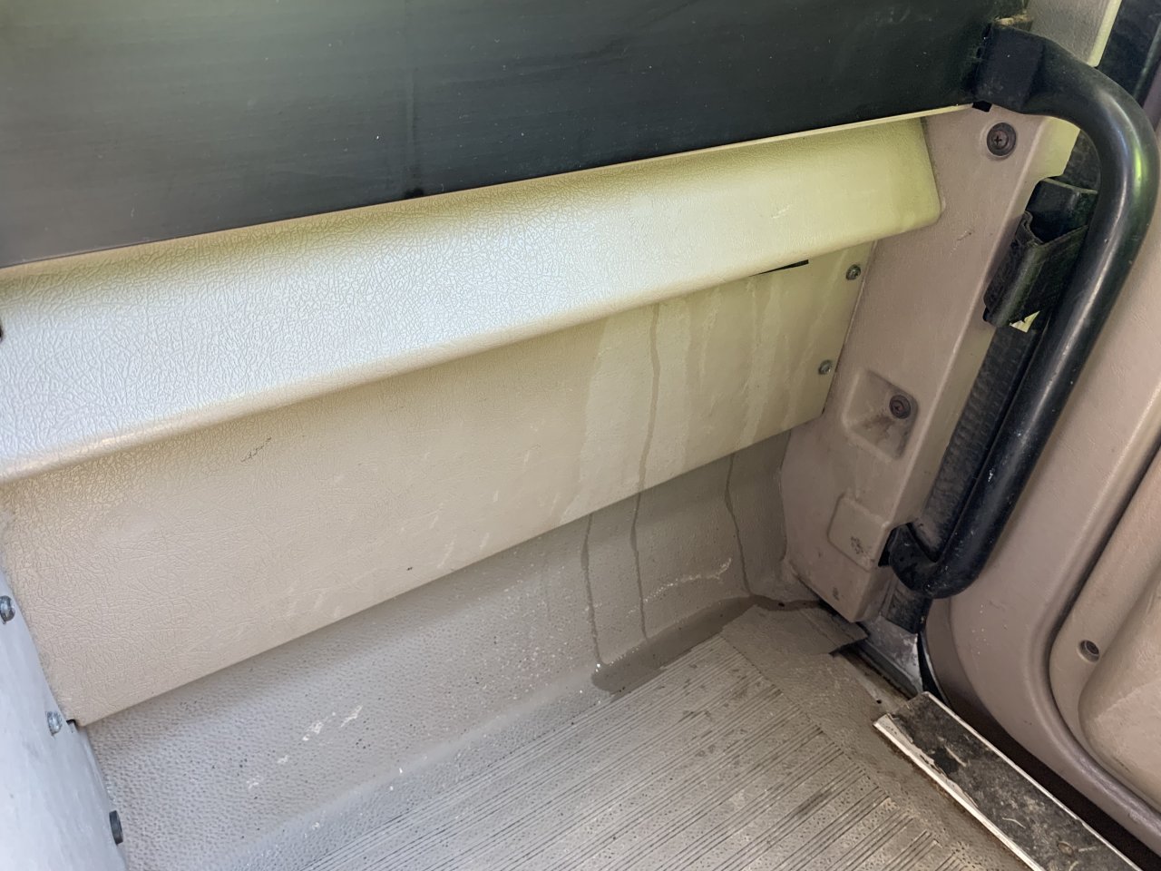

    What could be causing this? And is that hole supposed to be on the floor there?

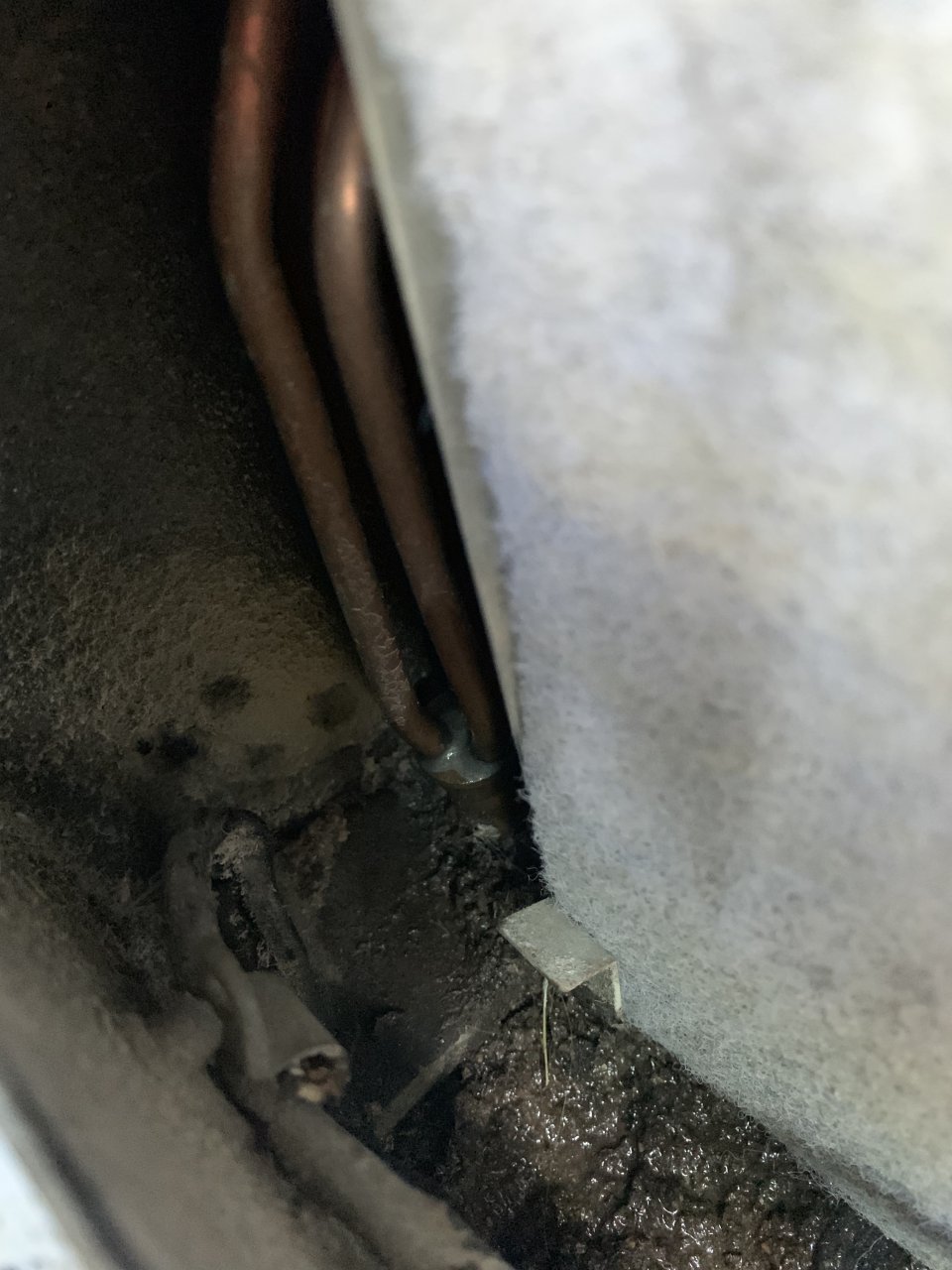

    When the ac or defrost is on, that evaporator will get cold which will produce condensation from the air blowing over it. This is will get very wet and actually drip lots of water on a hot humid day, which is why the drain holes are there.

    This is happening now.

    The drain pan is leaking or the drain hose is disconnected or plugged
