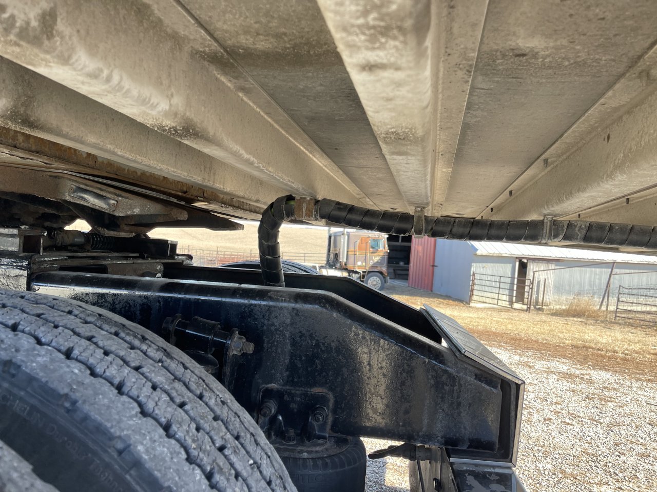

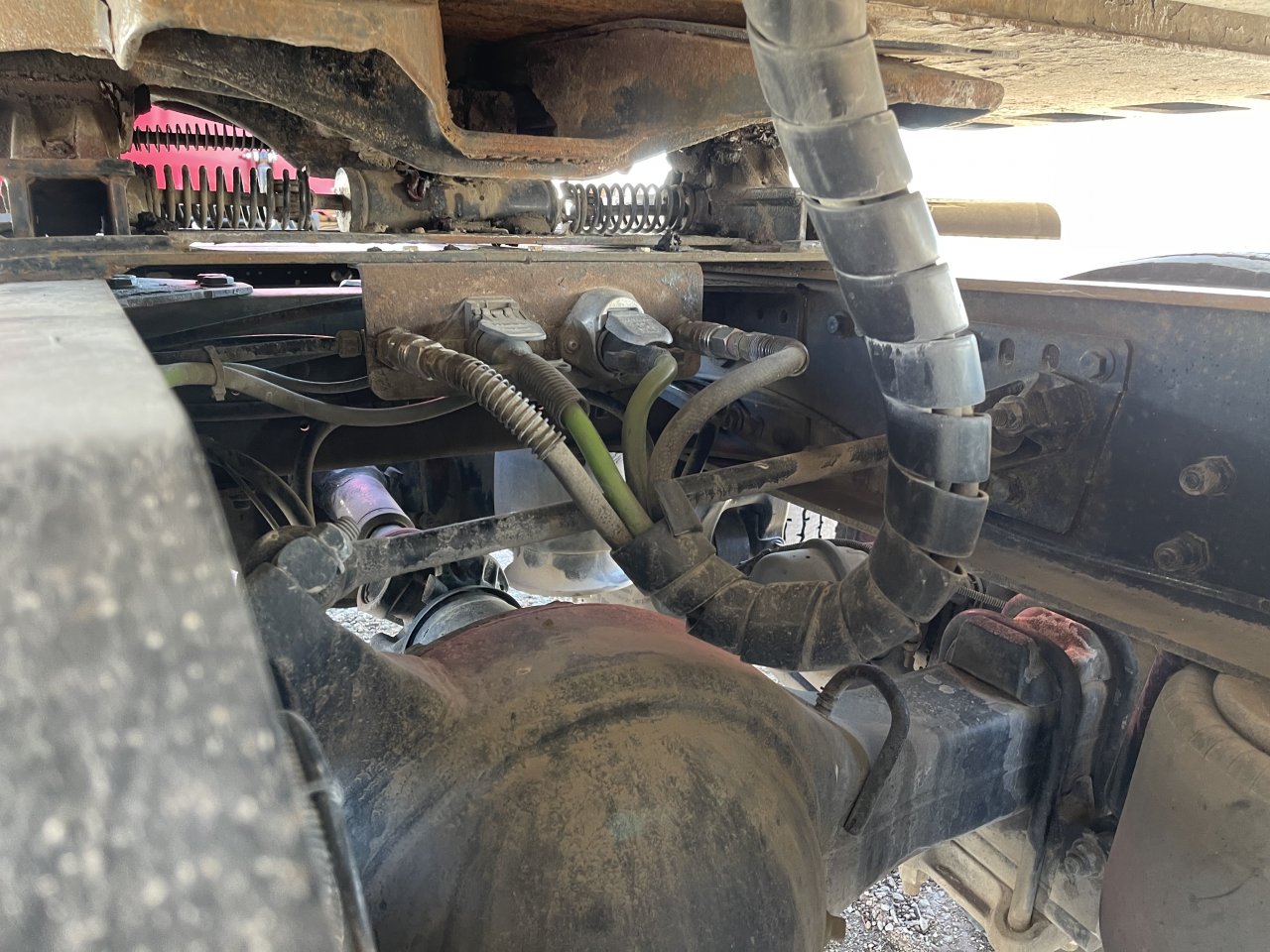

    Here’s a friend of mine from NE. You can basically do the same thing and not need much slack in your lines.

  11. MacLean
    MacLean Road Train Member
    1,307
    3,882
    Sep 12, 2017
    Why no quick connects / glad hands on the lines? I’d think that would be a pita dropping the trailer and what is the second power cord for?
    Siinman Thanks this.
  12. Long FLD
    Long FLD Road Train Member
    11,905
    48,901
    Mar 4, 2015
    The airlines have quick connects on them. The second power cord is for the dumps and stuff on his trailer axles.
