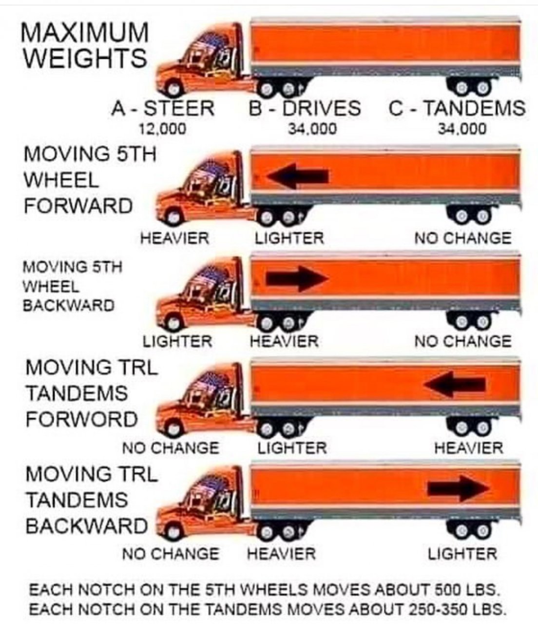

    I keep this as a quick reference guide.
    MACK E-6, KB3MMX, kemosabi49 and 2 others Thank this.

    Slide your fifth wheel up as far as you can to be able to still bend to 45 degrees without trailer nose to cab impact, and leave it there. This will not only help fuel economy, but it will help you in getting your weights legal.
    Now in the case of what you were dealing with here, there is no way you can axle that out without getting north of 12k on your steer. You need the wiggle room when you go to adjust your trailer tandem.
