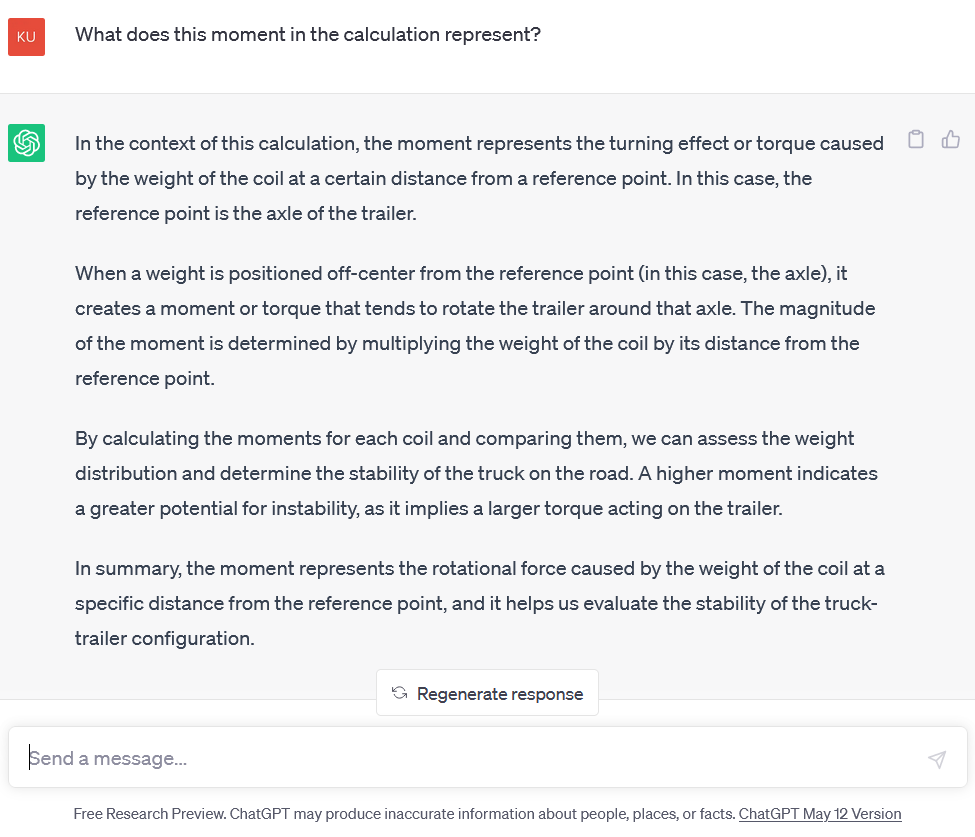

    I tried new technologies and they're insane. This is ChatGPT. Taking my hat off.
    Upd. Continuation. That's nuts.
