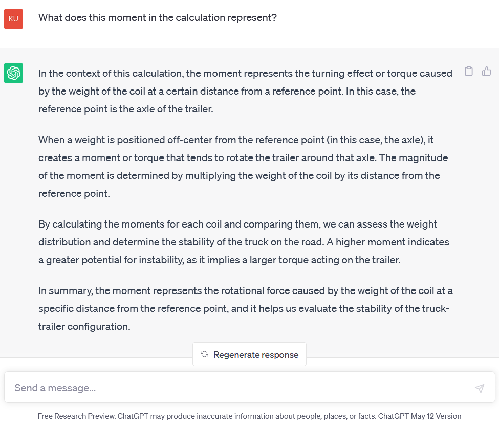

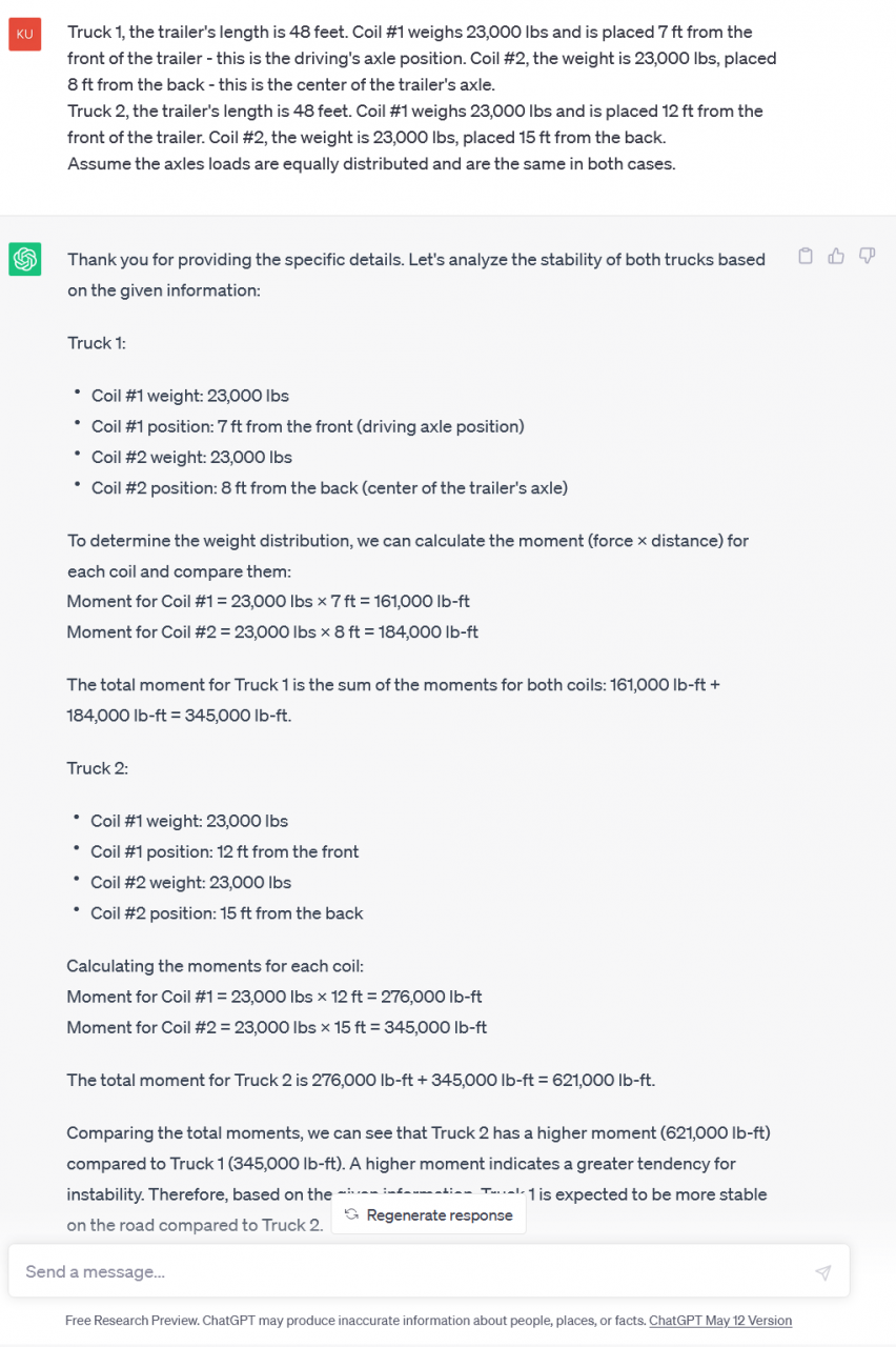

    And how many coils has that AI program secured? Just asking. :)

    I believe those moment calculations are wrong because they are calculated from different ends of the trailer. You would add the moments if they were both calculated from the front of the trailer. The way you gave the AI the problem, through it off. The second coil should be calculated as 41' from the front in the first example and 33' from the front in the second example.
    badvik_83 and gentleroger Thank this.

    Yes, that was my thought, too. Just to start with that the difference shouldn't be that big. Anyways, the way you can ask questions and get replies and explanations mow - that has blown my mind. I tried asking in multiple variations and the more precisely and declaratively you lay things out, the more accurate response you'll get.
