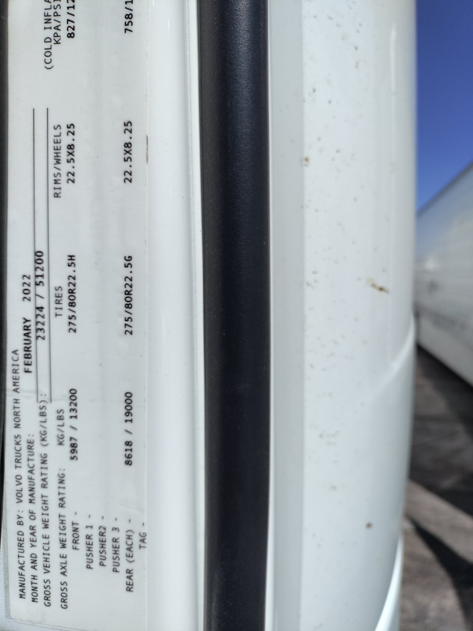

  6. Sixela918
    Sixela918 Light Load Member

  7. God prefers Diesels
    4,198
    22,269
    Jun 26, 2020
    South Texas
    13,200. Good to go as long as you've got enough tire under it.
