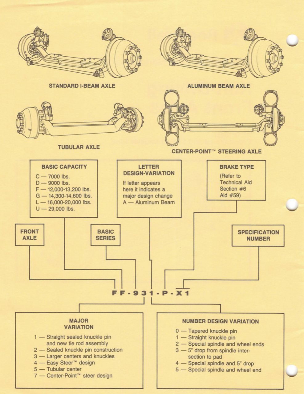

    Higher weight ratings then the 12,000 has been around for 60 years or more. E24D9414-C976-4A03-93BA-7067B59476A6.jpeg
    from 1965 Rockwell Manual. Options for all Peterbilt truck models. The aluminum beams were rare but common back then to make a tractor weigh 10,000 empty.
    My ‘67 was spec’d with a 13,200 FE900 back when 10:00-22 load range F’s were the big rubber.
