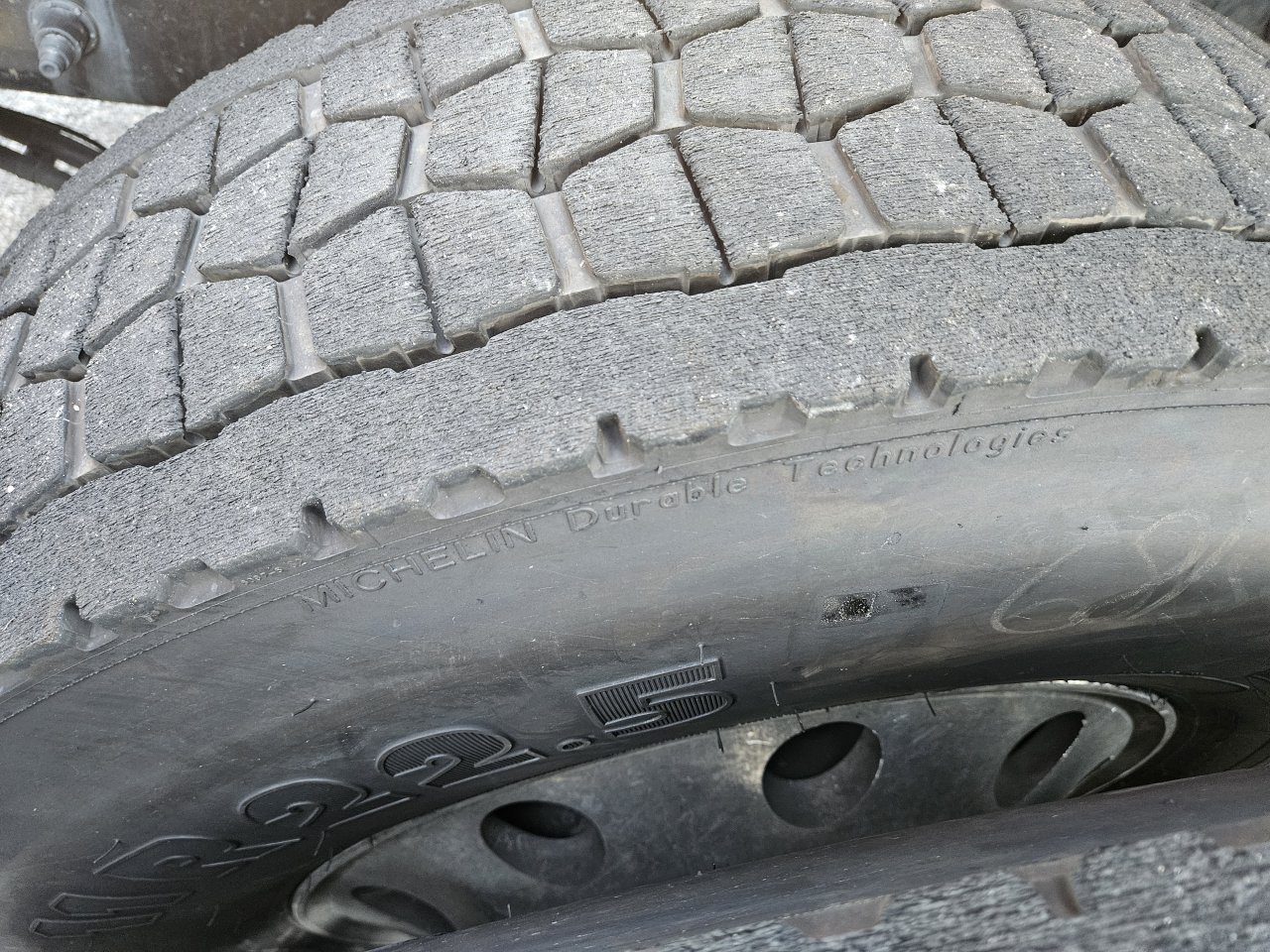

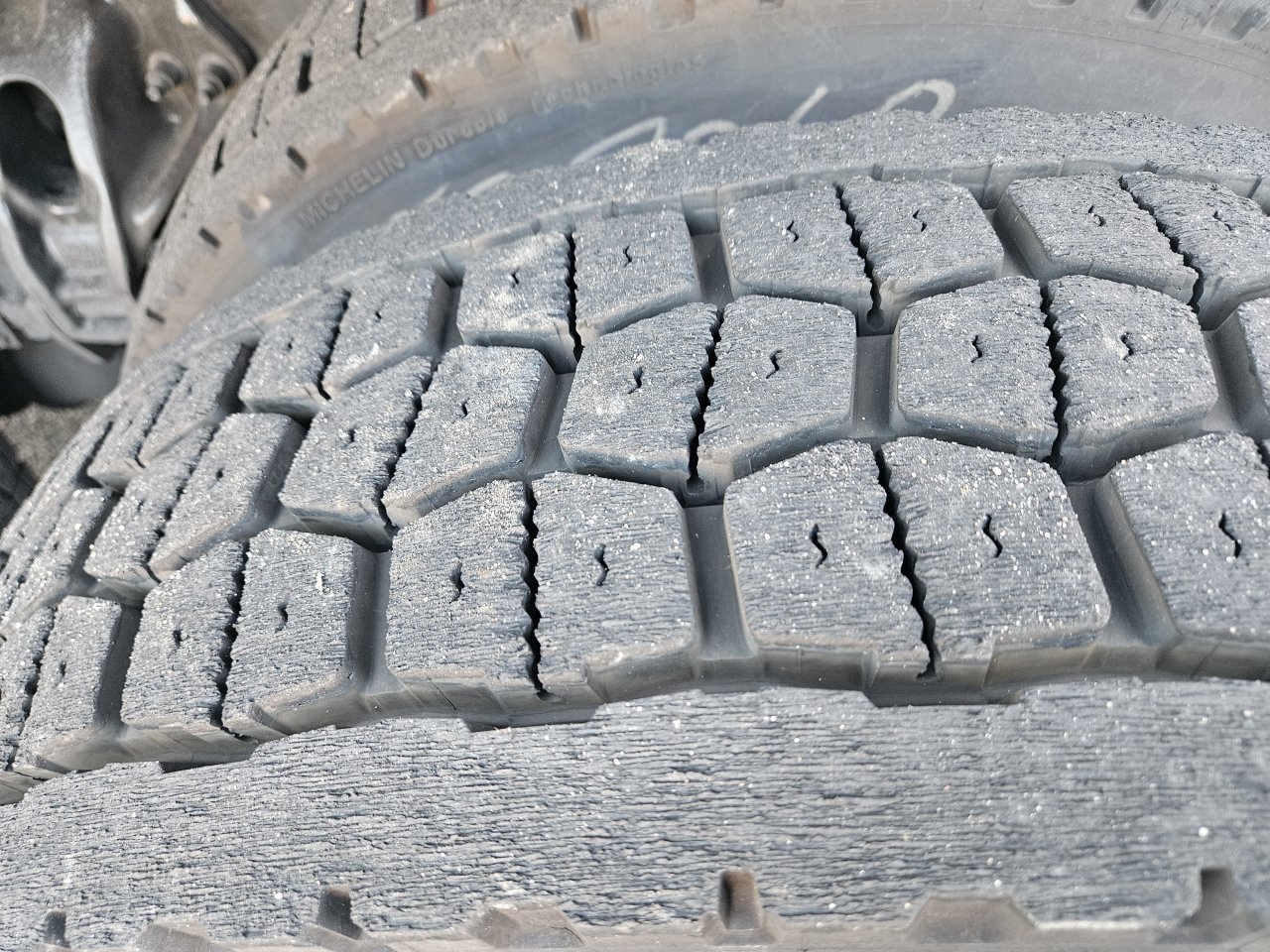

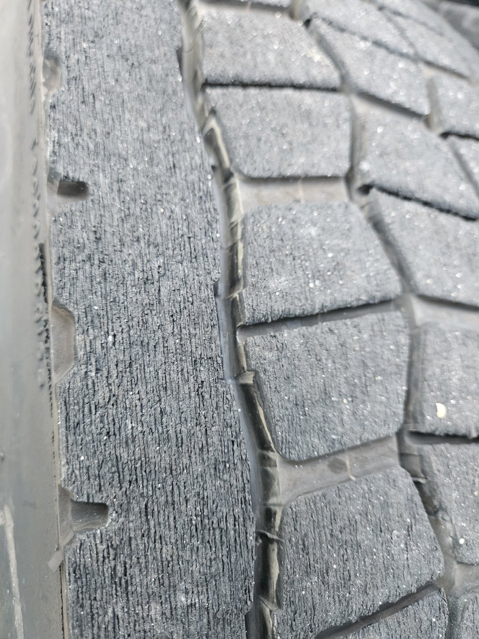

    So... I have a weird problem, when I'm driving, my trailer is going from side to side, now at first I thought it might be the wind ( about 8mph ) but I don't think it's big enough to do that, I have a Tanker btw, about 48,000+ lbs, and I didn't see the other trucks that was passing me doing that. It’s not big but it's doing it enough to be noticeable a little, now, my other suspicion is that something's wrong with my fith-wheel, reason being is I think I can see from my mirror that the trailer is a little crooked to the right, so at high speed, it tries to go further to the right and I have to correct it and try to make it go straight and follow my truck hence the side-to-side motion, I don't know what's wrong with it, maybe I backed into the trailer at an angle or something. One more thing, I got all my drive tires replaced, some of them look like retread to me, and no, I haven't call the shop yet, what do you guys think? Thanks!!

    Tires have been shaved. Those XDA5’s have inch deep tread new and will cause the tractor rears to sway. I bet they shave them down in your application to eliminate that sway because of pulling a tank.
    As for trailer sway. If you can. Hook to a different trailer and see what it pulls like. If it is same. I’d look at fifth wheel rocker pins. If it pulls good like it should then it could be the trailer king pin plate or suspension problems.
