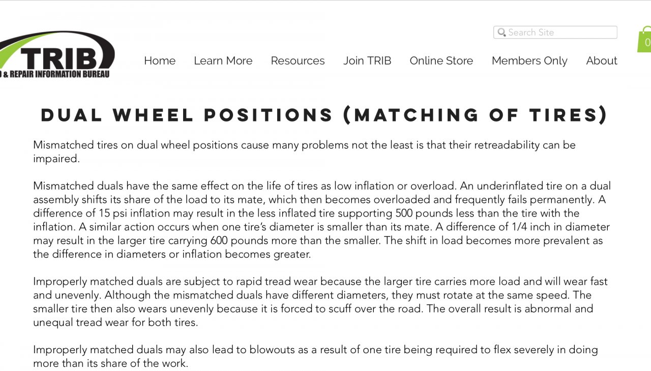

    I guess both tires can wear.
    But as the above article states I have also seen accelerated crazy wear patterns on the larger tire in mismatched dual applications including high heat because it is carrying so much more of the load.
