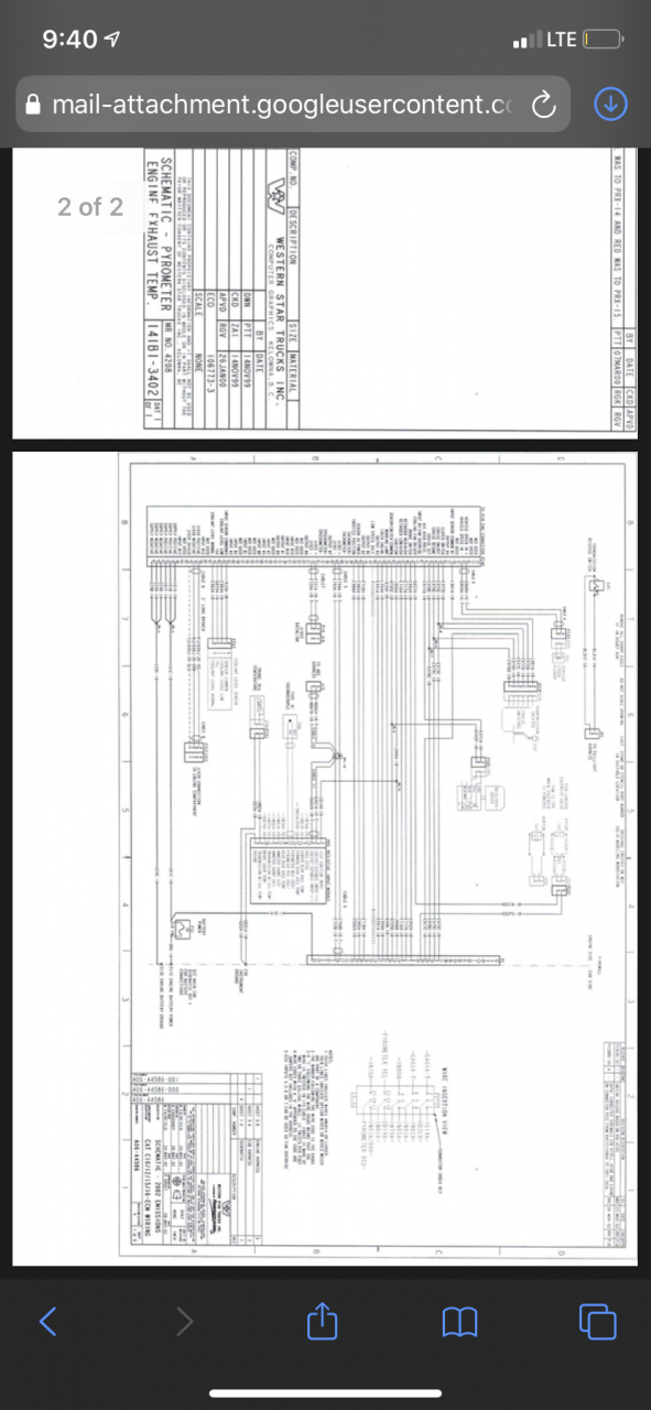

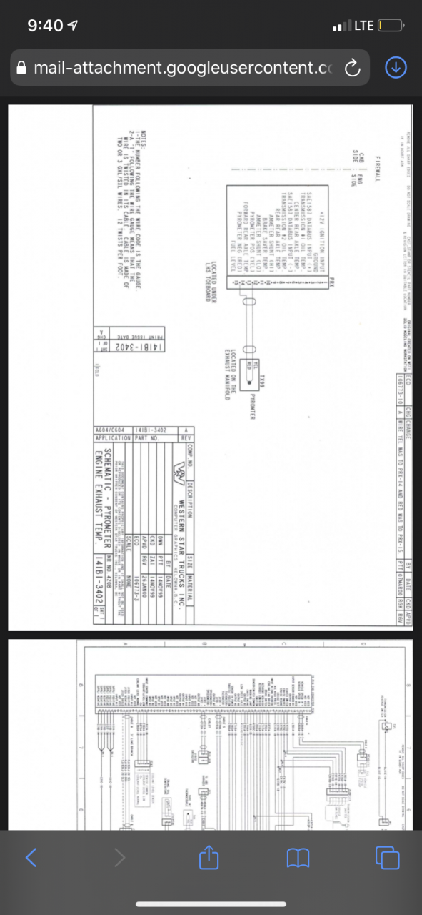

    Here it is. After hours in a shop it took me 5 minutes to read this and determine the issue on my EGT gauge was the wires were not in right holes they were flopped. But-connectors and the right gauge wires later and it works... if anyone needs help lmk. Also, have several c15 ecm flash files and in proficient In cat ET.
