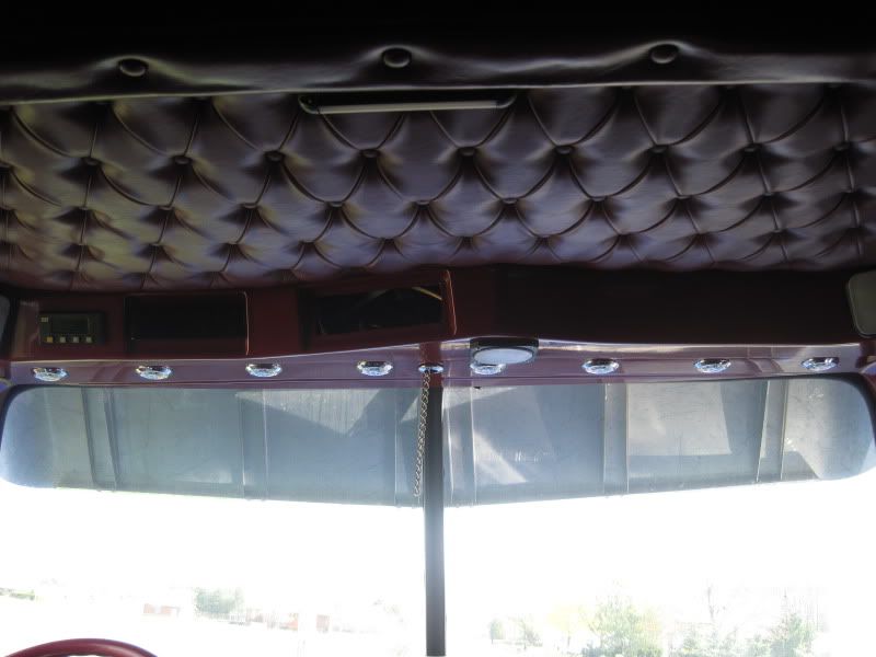

  7. underpsi
    underpsi Road Train Member
    1,266
    292
    Sep 18, 2008
    Toronto, Ont
    Too bad you didn't post on here first. Could have helped you out! I too ran into the same issue with my 2000, they are famous for cracking around the CB and am/fm radios.
    Heres my solution
    Had all the plastic interior panels custom made out of fibreglass. Everything is a smooth finish and painted red now except for the dash, thats gonna be my next major project.
    If anyone needs any of the panels (top centre console, both side pillars, upper door panels, or the side roof panels) I can get another set made again. I had a mold made for them all.
