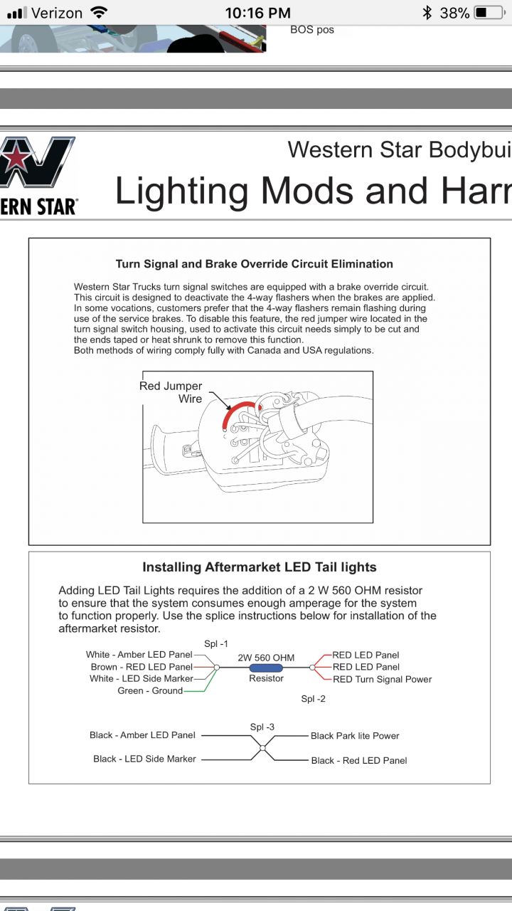

    I did exactly as the instructions suggested.my DRL are still staying on.i do have aftermarket headlights btw.any suggestions???

    Will this procedure work on a 07 Western star 4900ex, I have led headlights that are flickering on DTR mode but not when I turn on the headlights switch

    I had put aftermarket LED headlights on my 09 and they were flickering on the DRL MODE.but after removing the wire suggested in the write up they are working normal now.

    My 2017 5700 has a different set up from the picture. I did cut the wire to A10 and G. When I cut/disconnected A10 I lost all controls on the steering wheel, cruise, am/fm horn, turn signals everything. It did kill the DRL. Any suggestions as to what I did wrong? There is a top and bottom plug that both have the G cavity. I tried it with each of them. Cannot read the numbers on the wires

    On my 18 5700 I just pulled the fuse for DRL’s and that worked. No need to cut anything.
