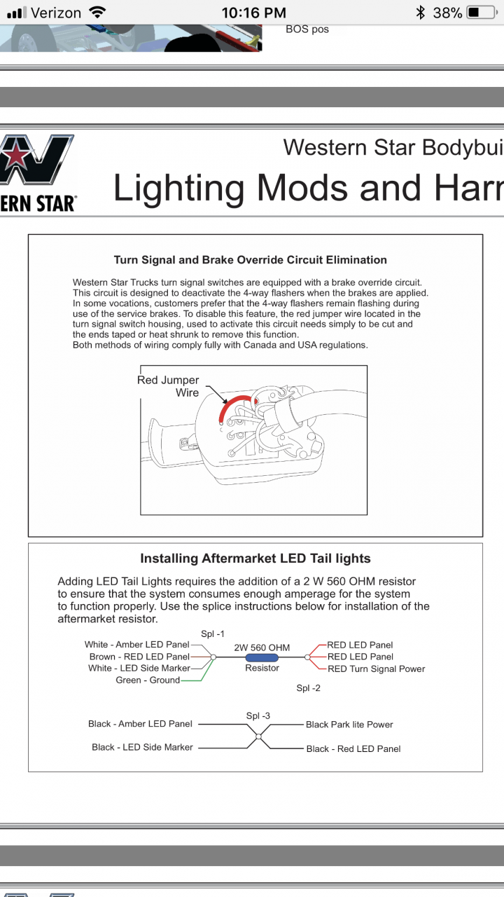

  5. Blackshack46
    Blackshack46 Road Train Member
    Two red wires on the bottom side of the turn signal stat. I cut the back red on further down the steering column in case i need to fix it. Sure enough, its the right turn signal so had to repair that.
    Are you guys talking about the front red wire that looks like a jumper? Only the yellow and red jump are connected to that front plate.
  6. Oscar the KW
    Oscar the KW Going Tarpless
    12,247
    28,119
    May 19, 2011
    From the WS Bodybuilder Book, clip that red wire and use electrical tape on the ends.
    Blackshack46 Thanks this.
  7. Blackshack46
    Very much appreciated. Thank you.
  8. Blackshack46
    Problem solved.
    In what application is having the brake lights turn on and 4 ways off, the ideal situation?
    I do many backs off country roads and its annoying when pulling up to a farm driveway but my warning gets confusing I think to the cars behind me because its 4 ways/brakes/4ways/brakes. Or even worse the approaching traffic just sees a truck slowing weaving across the two lanes of road.
    When is that a good idea?
