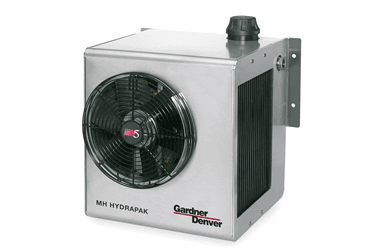

    If you don’t like long Pto driveshafts you can put a direct drive Hyd pump and a hydapack cooler into your blower....no shaft anywhere.
    MH Series - Hydrapak Oil Conditioning System
    I’ve got 2 direct drive Hyd pumps on mine.... one on the bottom port with tankless cooler set to run a product pump.... and the other on the side port with a 65 gallon tank (no cooler) for a dump trailer....
