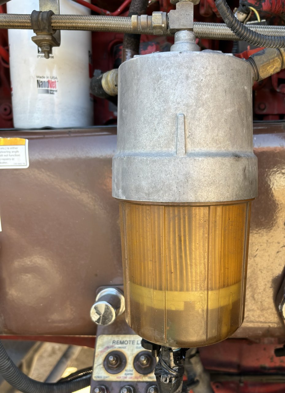

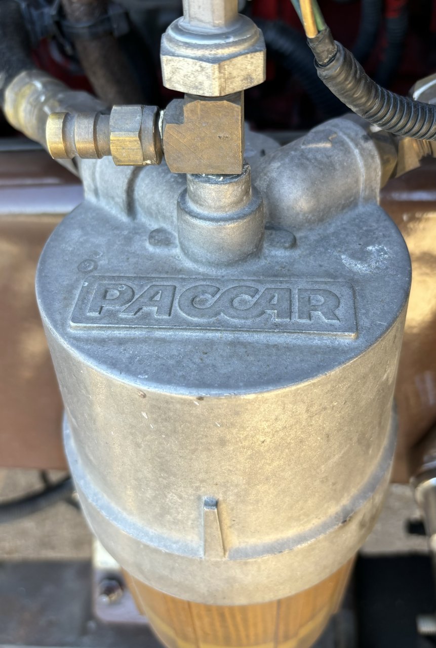

    I’m curious about the difference between the Davco and Paccar ……… almost look alike
  8. Goodysnap
    Goodysnap Road Train Member
    3,710
    9,005
    Jul 12, 2017
    Davco is still an option on both Pete and KW with Cummins engines. If it has the rounded globe on top they are all Davco.
    MX engines 22 year and newer have the water separator on the engine and is now an engine part not frame mounted.
    The Paccar fuel water separator has a bowl on the bottom. Aluminum housing on top.
    Diesel Dave Thanks this.
  9. Diesel Dave
    8,655
    24,452
    Jan 20, 2010
    Hesperia, Ca.
    On my 2014 Pete
    Big Road Skateboard and Goodysnap Thank this.
