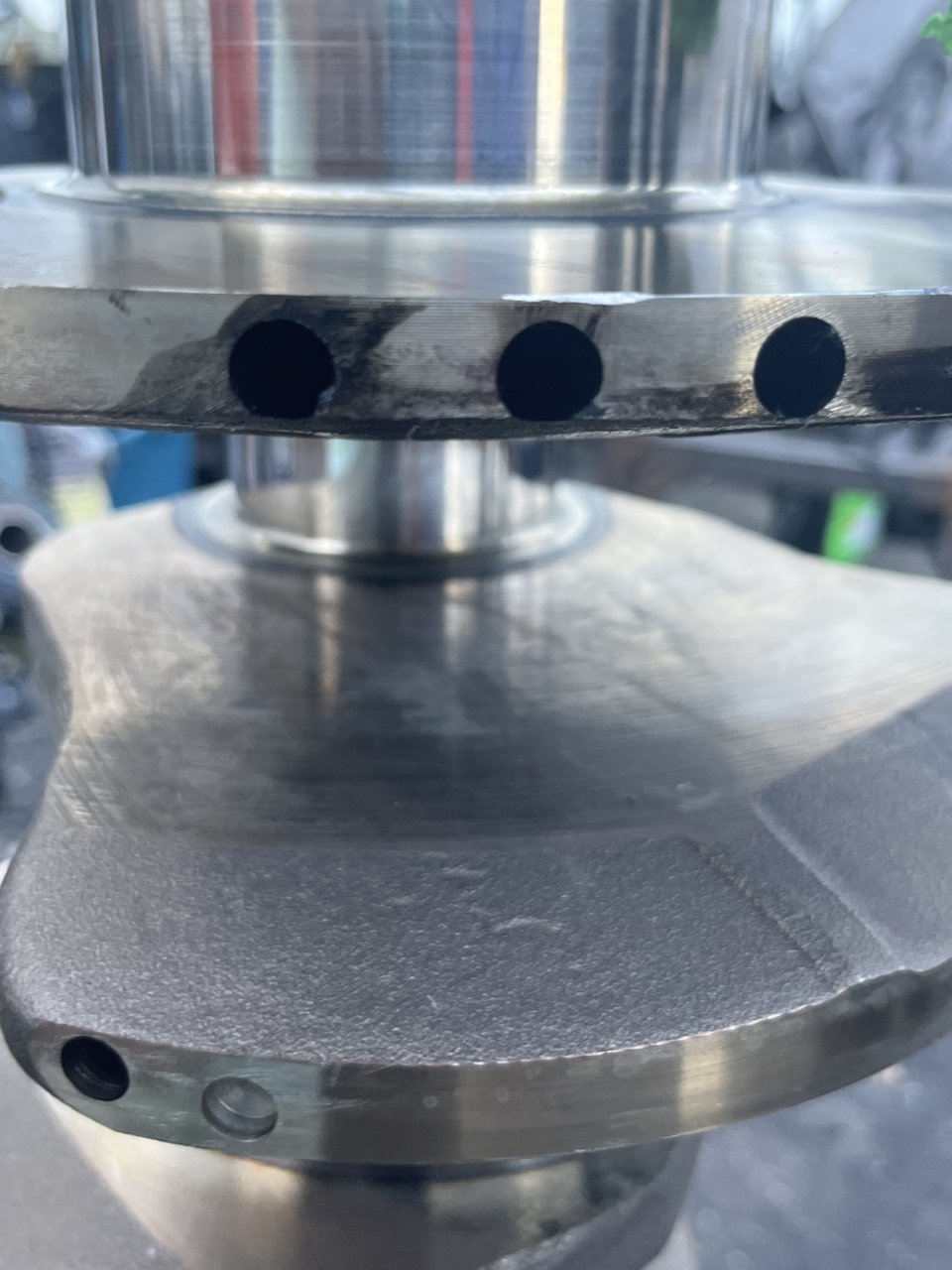

    I dont fully understand everything that goes on inside a motor so ill ask this best I can. The center of the crank...the smooth metal part, I assume bearings go around those and it looks like the bearings have been rubbing against that..... Any reason why? The way I understood it was as following..... there was a small piece of a cylinder ring that had broke off and was stuffed inside a nozzle that allows oil into the crank. So no alot of oil was getting through or something...... didnt help that my oil was kinda sludgy.

    A pic would help. No way for a broken ring piece to get into a pressure galley. I don't see anything obvious in the pics you posted above

    On the side? Maybe thrust washer rubbing. I think @Big Road Skateboard mentioned once that bumping a dock too hard, can cause that. My friend did just that. Luckily he also decided to change the oil pan gasket. Found the thrust washer Laying on the bottom of the pan. It was damaged pretty bad. Crank scratched up too. We used some emery cloth on the crank. Put a new thrust washer in. DD said proper repair was line boring and a new crank. Hopefully it stays together till he gets a new reman engine.

    Ill get some pics up tomorrow. Not sure what ill get pics of though.....I know the crank is gone as we found a new one to exchange...
