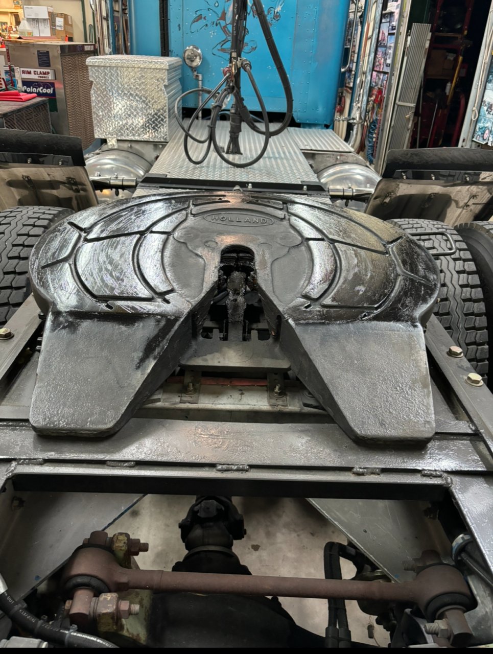

    Holland FW35. Invented by August Fruehauf in 1935. Tried and true and there are still 40-70 year old ones out there still in working order to prove it. I have one from 1967 with 3,654,749 miles on it. If you are having to replace the other brands all the time that should tell you something.

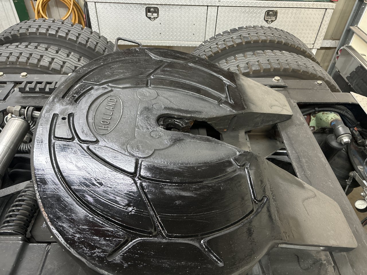

    I been running a plastic disc for the last 20 years so when I unhook i spray some rattle can black on it so no surface rust. Even has the omg right side manual jaw release.

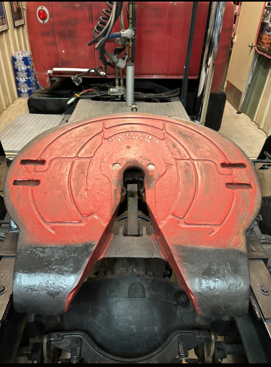

    Heres the FW35 on my GreatGrandfathers 1951 Diamond-T. It’s original so I’ll let you do the math. Been thru heck and back. You can see how king pins wore into the ramp ears from trailer swaps. I rebuilt it 8 years ago with new kit and jaws. Works like new.
