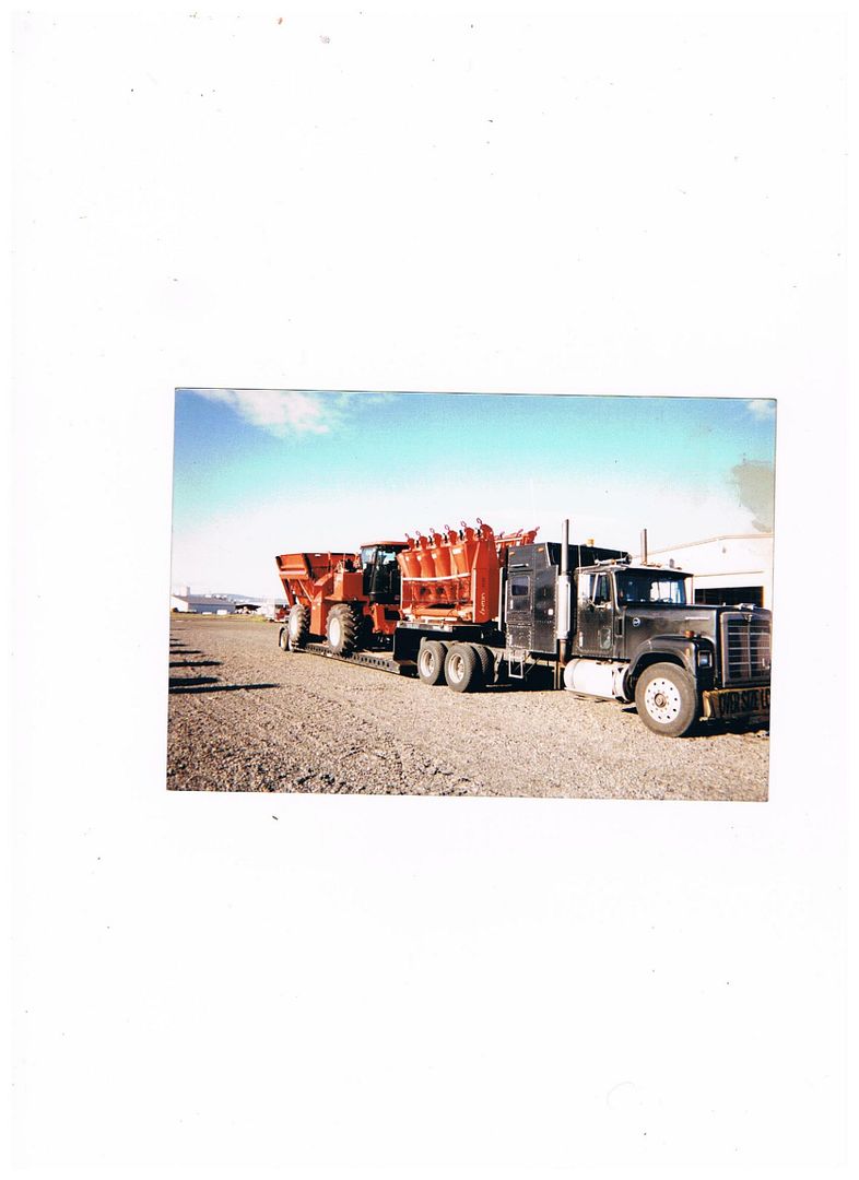

    Thanks,had a lot of seat time in my 4300's between the two of them. Big comfortable cab. Easiest truck to work on ever. That whole dash folded open in a second and lifted out of the way to get to all the wiring and plumbing. Here's a pic of my brand new 77 Eagle the first day I brought it home,with my dear mother. Second pic is out in Pasco Washington,unloading a bean harvester. Third is in Orlando,Fl at the FMC plant hauling deicer trucks.
