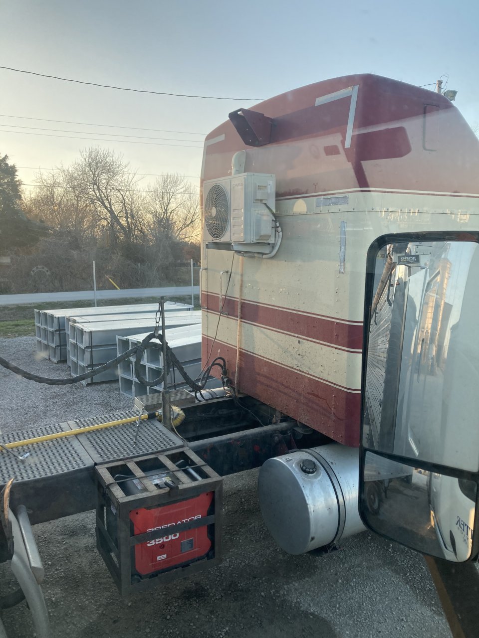

    My standard 135A alternator hasn't played as big a factor as I expected. Before I installed solar, 2-3 hours on the road and I'm fully charged. Now much faster. The solar is always on and charging as needed, even when the truck is running. When it fails, I'll look into a higher amp model, but not to any great extent or money.
    You should measure the amperage the camera system is pulling. That would bug me, I'd want to know the actual numbers. Also, is your solar panel setup a portable like the HF kit or an installed setup? Either way it wouldn't be Rockefeller money to expand that enough in the mean time to keep up with the cameras on extended parking. Maybe better truck batteries too?
    My inverter displays output watts so that has helped me size things up like this. I also have an old OTC multimeter that will do inline amps up to 20A for anything hooked straight to 12V. A similar discovery I made on mine was the mini-split pulling about 100W while turned off. Just the power to keep the circuit boards awake and listening for the remote. Solution: I unplug it when I'm not using it.
    Which brings me to something you'll see as you dig into learning more about solar. Internet searches will take you to off-grid home applications and RV setups for primitive camping. You'll see a recurring theme of people that discover it's nearly impossible to duplicate the convenience of utility power without a running engine. Then they start doing some practical load shedding and find out they can manage with a lot less than expected. You do have to be more mindful of how much crap is running while your parked, and also park pointing the panels at the sun where possible. Definitely more care required than a set it and forget it situation with an apu or genset.
    I mention that because my original plan was 4x160W panels. The fourth one wouldn't fit right, so I went with the three. Now that I've lived with it for a few months, it's clear I'll get more bang for the buck with a fat set of house batteries and an isolator. My problem of running HVAC all night on a 10 hr break will be solved by storage capacity and load management, not additional charge amps in the daytime.

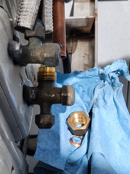

    Figured I'd point out a negative with the mini-split solution, since I'm now suffering from a lack of foresight. I been meaning to get the EPA certification so I can buy more than just 12oz cans of R-134a at the auto parts stores, but never got around to it. Always was a back burner thing and I never looked into it seriously. Now it's come back to haunt me.
    One unit came in not cooling. I discovered the suction line had cracked at the base of the flare and let all the magic smoke out. You need a EPA 608 certificate to buy R-410a, really any refrigerant in quantities over 2 lb. 410 is hard to find in small cans, and the markup is astronomical. Today, the repair is less than an hour to either put a new flare on the end, or replace that line if it's not long enough. But for immediate service, I got to hire an hvac guy to come out and charge it.
    This week I'll be getting the EPA cert and ordering a 5 or 10lb tank of 410. Might even get a tank of 134 while I'm at it, since I use that often enough. One of those things you need to have in place ahead of time.
    ETA: these mini-splits come pre-charged in the compressor unit. Once the system is installed and vacuumed down, you open the service valves and the charge is released into the system, ready to go. Thus, you don't need to purchase any refrigerant separately to install a new one.
