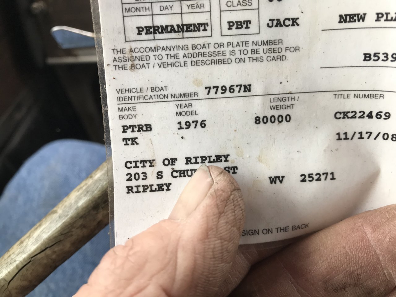

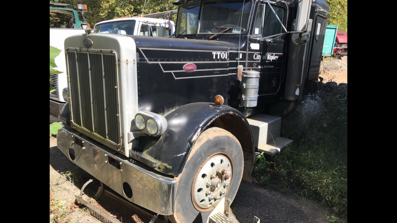

    Ok, here’s a real life example...., This truck was owned by the city of Ripley here in WV. In order to achieve the best of both worlds..... they ordered it with 2 speed rear ends. Hi for on highway, and low for off road and hard slow pulling when loaded.... and has a wet kit for a hydraulic trailer..... something you may think about too?? 6E7B0147-0593-4DB3-A51A-10D1A18B12F8.jpeg 411297D9-6E48-42FA-9FD7-06E4AEE1FDBB.png 8E33397F-D703-45BF-926E-BE6DC5CE255C.jpeg
