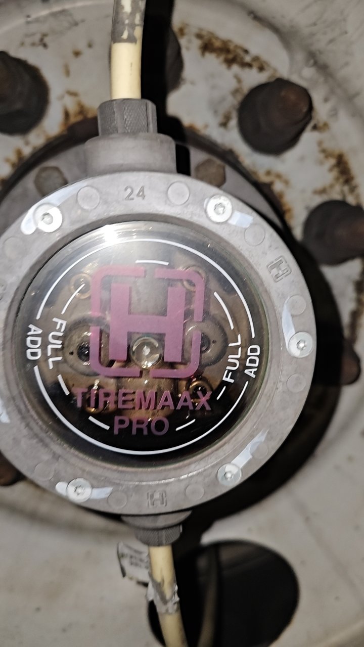

    And here are examples of the site glass for the guy who started the thread. The one that's empty is unsurprisingly the culprit Snapchat-1207279005.jpg Snapchat-1592432993.jpg
    Phoenix Heavy Haul Thanks this.

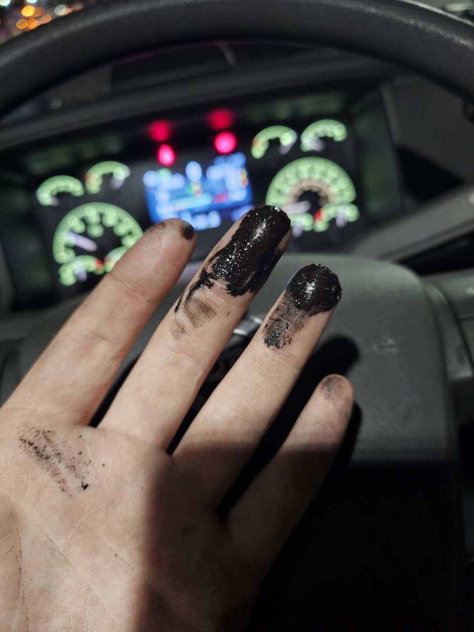

    Alright, I guess I'm the new guy with questions: Swung by a TA on the way to delivery close to our terminal for a quick opinion from tech at TA. Was told this is normal. Am I being too 'strict' about seeping and it really is normal? I know truly blown wheel seals are an obvious issue and needs fixed immediately. I was always under the impression that seeping, especially wet to the touch, is worthy of knocking out. Maybe not and I can save myself the headache?
    Magoo1968 Thanks this.
  8. rollin coal
    rollin coal Road Train Member
    13,758
    28,433
    Mar 29, 2008
    TN
    Yeah that needs fixing ASAP. Out of service if not wheel off about to happen..
