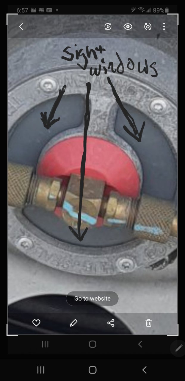

    There are no sight windows on the hub period.
  3. rollin coal
    rollin coal Road Train Member
    13,449
    27,423
    Mar 29, 2008
    TN
    They're opaque because it's grease packed but those are the "sight windows". They're clear on oil bath and have "low - high" oil level marks.

    So you think that the hub is grease packed because the sight windows are opaque?

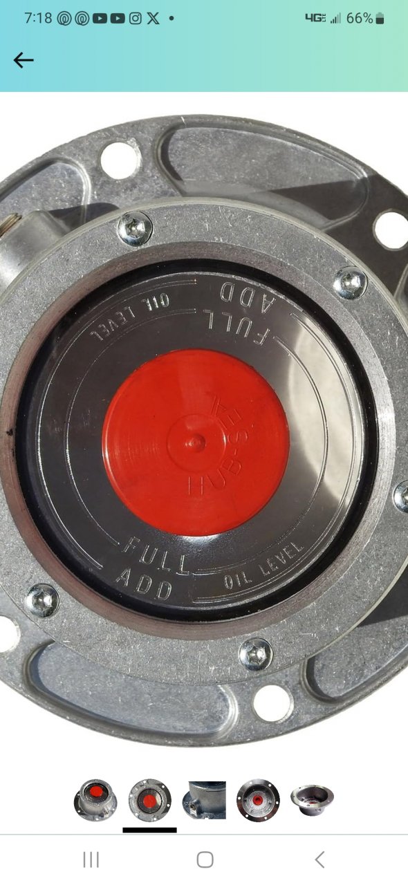

    Screenshot_20231005_071819_Amazon Shopping.jpg This is an oil bath hub cover. Looks very similar to the one you showed but slightly different. that's clear plastic in the middle so you can see the oil level of the hub

    It’s intended as an oil bath cover. But it’s either so old or someone’s packed grease in there that you can’t see through the windows.

    Looks awfully dirty to me, wipe it off and look again.
    We have some old trailers that you can't see the markings on if they are dirty like that and some are so bad you actually need to shine a light into them to see the level or markings.

    Before about 5 minutes ago, I thought that what you called sight glasses were just pieces of metal on the hub. But I went out to my trailer and wiped the sight glasses with a wet wipe, and what you call sight glasses really do appear to be sight glasses. It appears that it is made out of glass or plexiglass.
