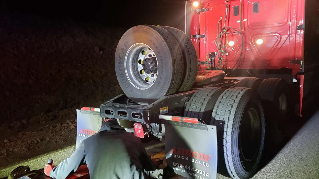

    You’re doing better than most, keep it up. Ever time I’ve had hub leaks I smell it before I see it, usually on the inside.

    I’d give you more then your asking price if that was covered in hub oil from the seal leak that caused the bent wheel.

    Wheel seals are pretty common failure, catch it before it causes a fire or loss of a wheel end.

    The outside is called the hub oiler. No moving parts.
    You realize a lot of us (especially the older drivers) have a very hard time comprehending someone with your experience having zero clue about the basic structure of the wheel end? Intellectual curiosity never kicked in? Yes, I realize not everyone has mechanical aptitude, but after a million miles, you've never seen a wheel end apart?

    Doesn’t have to be a seal failure to cause that. Hub bearing lock nuts coming loose is biggest cause. Left hand threads on left side and a simple fail safe cotter pin of days gone by pretty much made that a non issue 35- 40 plus years ago.
