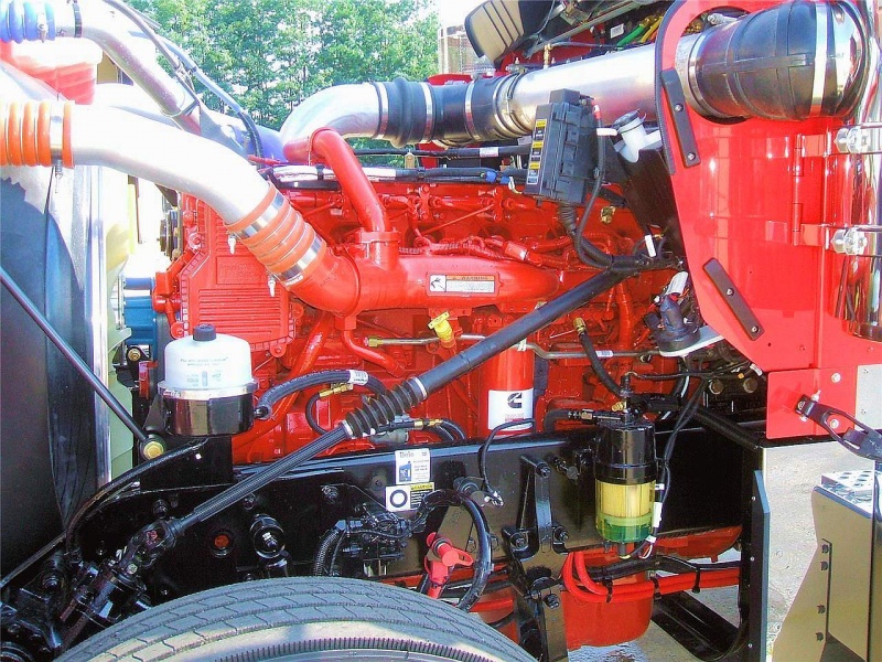

    Mine has that same Chevron sticker... its a 08'
