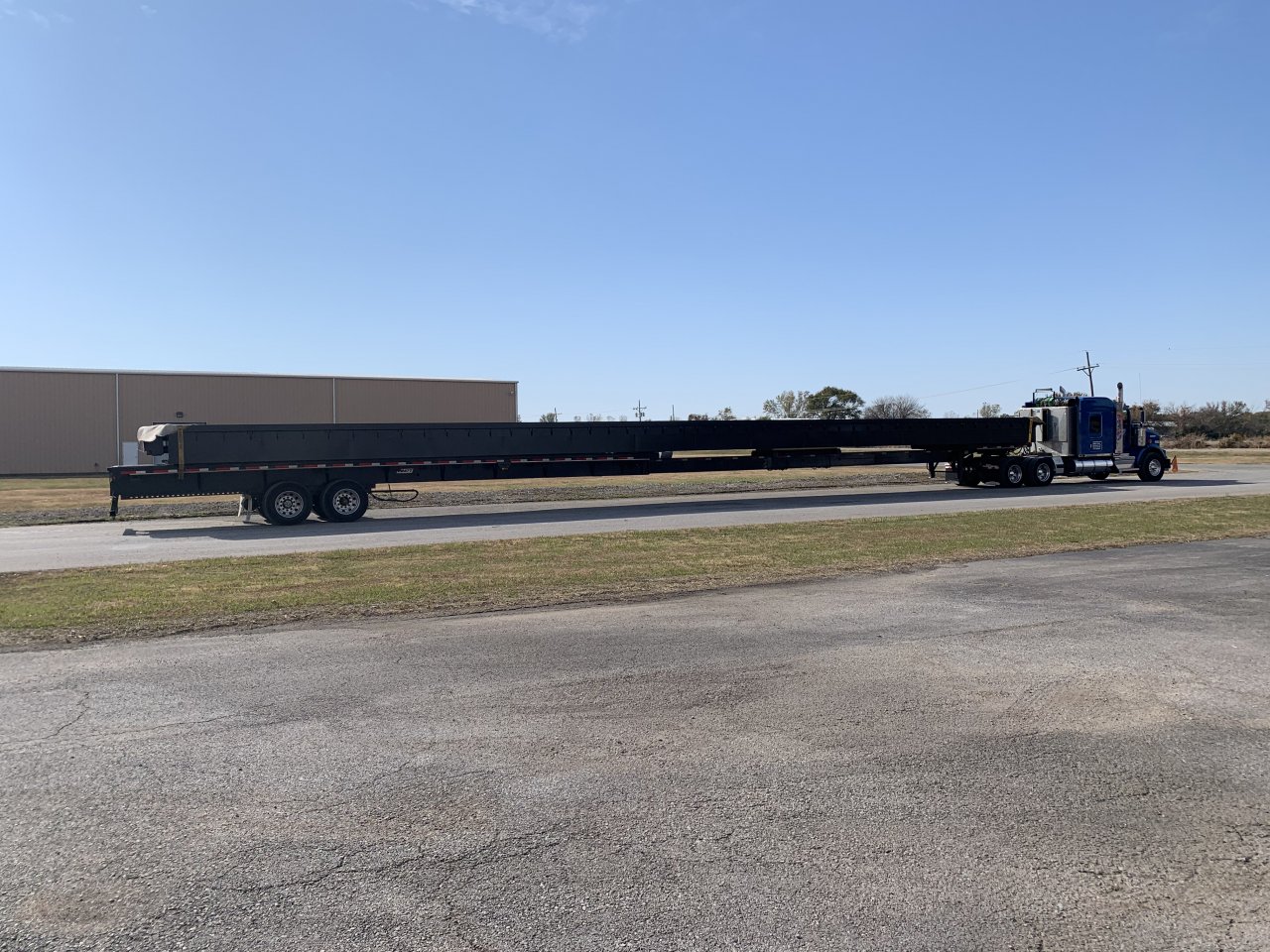

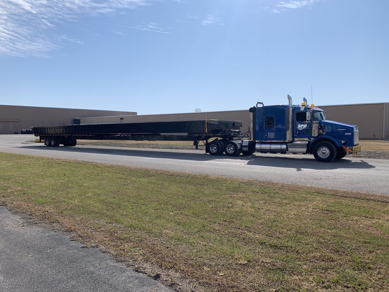

  9. kylefitzy
    kylefitzy Road Train Member
    4,724
    19,663
    Aug 12, 2007
    Kansas city,Mo
    630899A6-705E-40F6-918F-A2A60EDAB7DA.jpeg B0E62757-7DB4-40FF-92D2-05B68BC0A954.jpeg Who ever though it was a good idea to take these trailers down the road was a real #######.
  10. okiedokie
    okiedokie Road Train Member
    13,309
    103,486
    Jun 13, 2011
    PNWET
    Actually I've driven worst set ups. At least the stretch trailers have less moving parts. But with all truck applications there're short comings to each. Those stretch trailers need a steerable trailer.
