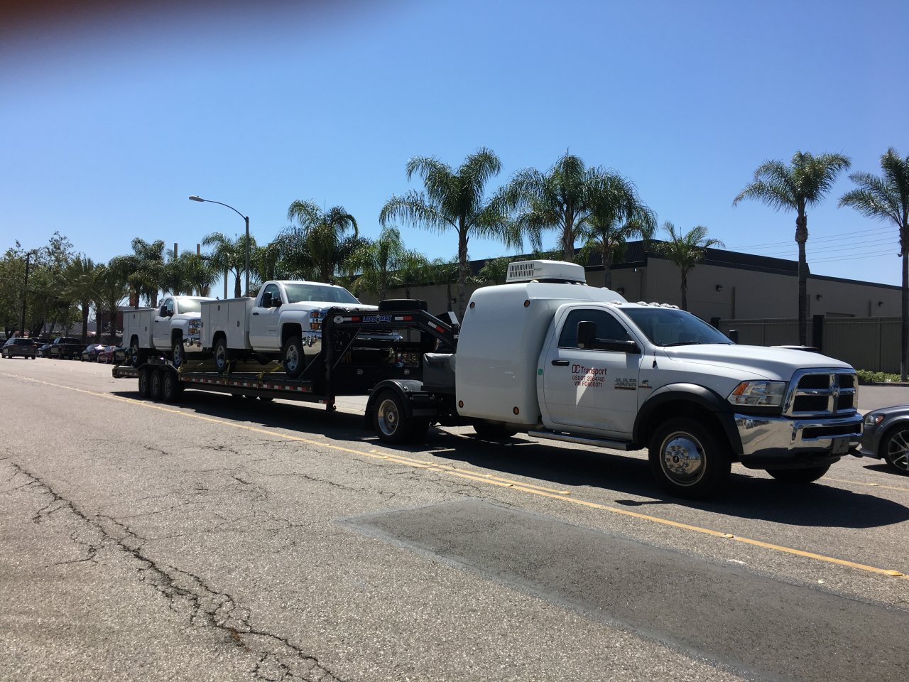

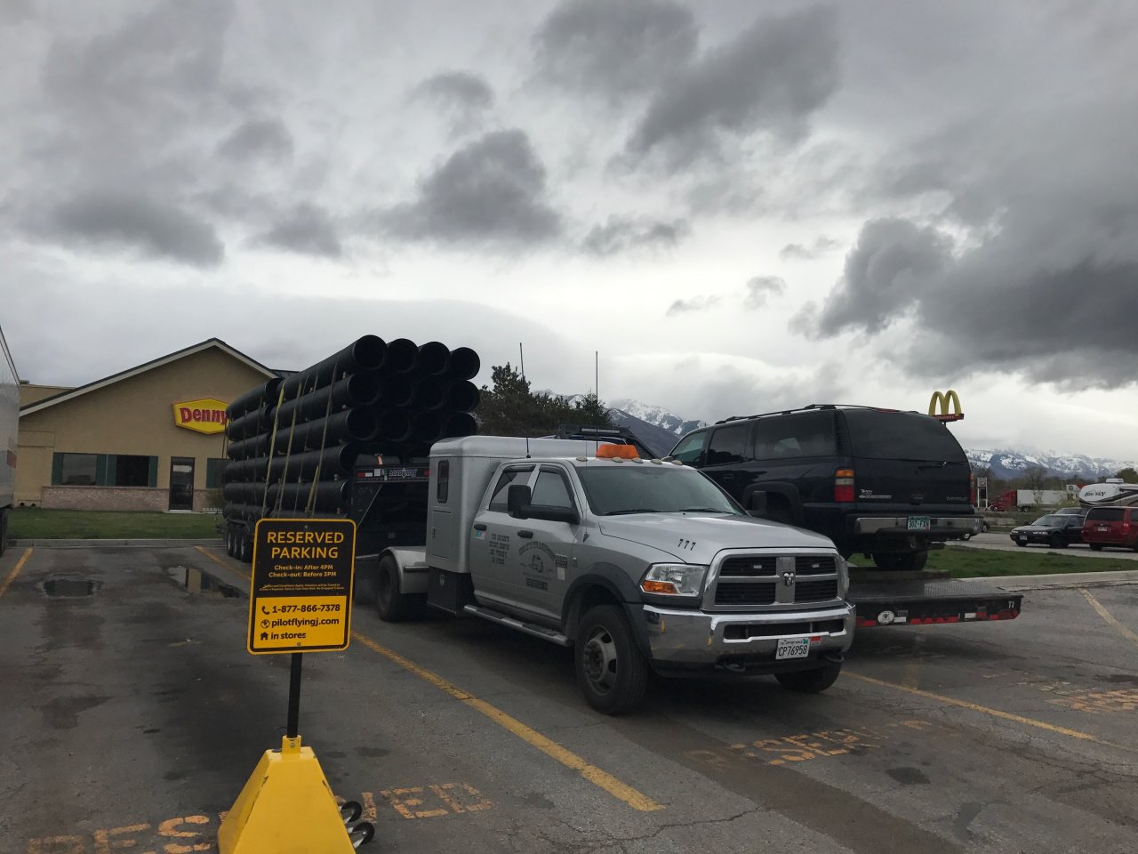

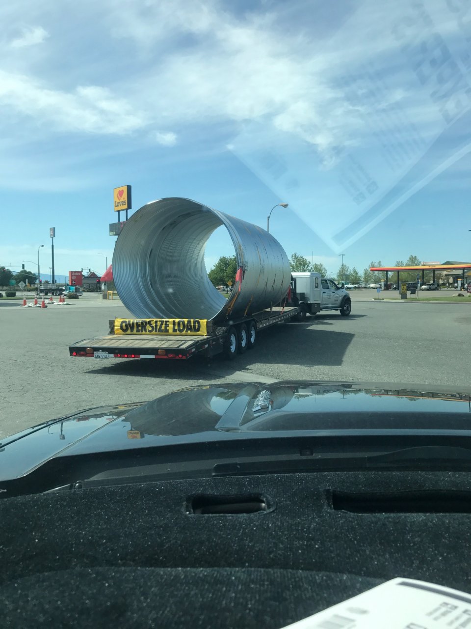

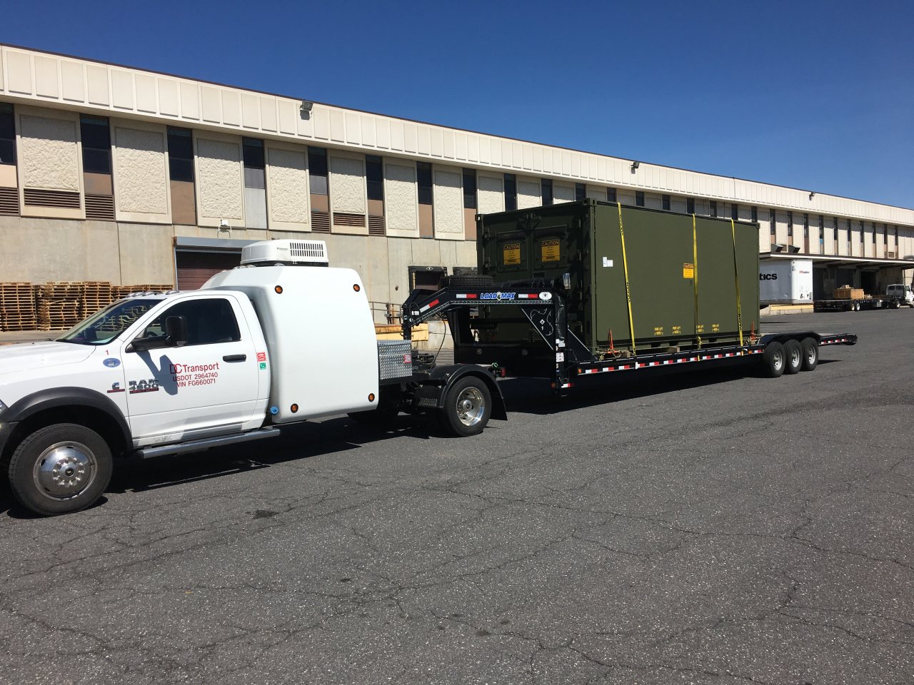

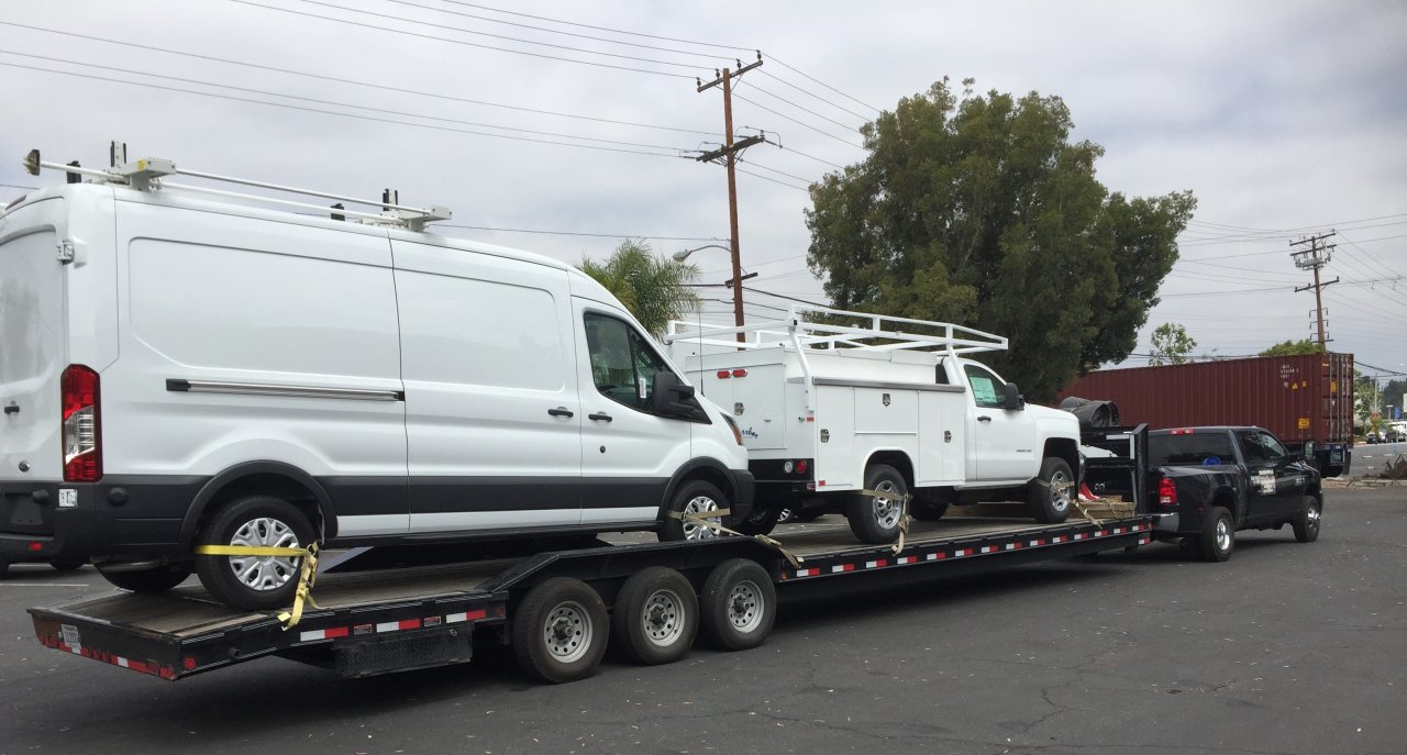

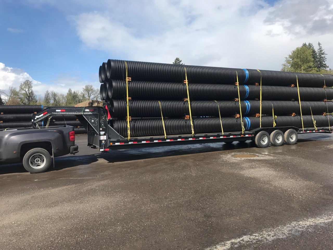

    It's really depends on how your equipment is spec'd out. Number of axles, positioning of axles, gearing, etc. we don't run tuners, or delete anything on our trucks, we're 100% stock from the factory. We run at and above 30k gross with some loads and our equipment handles it great, no issues. And as far as how it feels taking off, we can walk off and leave most semi trucks on a mountain grade.
