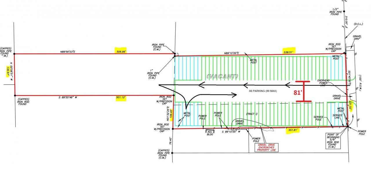

    Not negative at all and I appreciate the input. So my main question is, based on the layout, would 80’ between you and the truck in front of you be enough room for you to pull your truck out if there was a truck on both side of you?

    We have a truck stop just down the road from our house and my business partner and I will be driving through a few lots tomorrow. My main question is would 80’ or so between you and the truck in front of you give you enough space to pull out? Assuming there I are trucks on both side of you.

    when looking at the layout, would you be able to pull out of a parking spot? Assuming you have roughly 80’ to work with and there are trucks on both sides of you? 8F6D89A4-4926-4D5A-8C6A-9BA630846D27.jpeg

    Have you thought of angled pull through parking instead? You'll lose some spaces but might be worth it. Put barriers at front and back corners of the spaces. Keeping side swipies from happening.

    Yeah, that should be enough room between the parking spaces to pull in/out comfortably, even for a long hood or "long" wheelbase truck with a 53' trailer.
    That's about right. More is always better, but that isn't a "tight" parking area.

    If you make the blindside blue spots 2 spots wide the blindside back will be very easy and that space wont be wasted.
