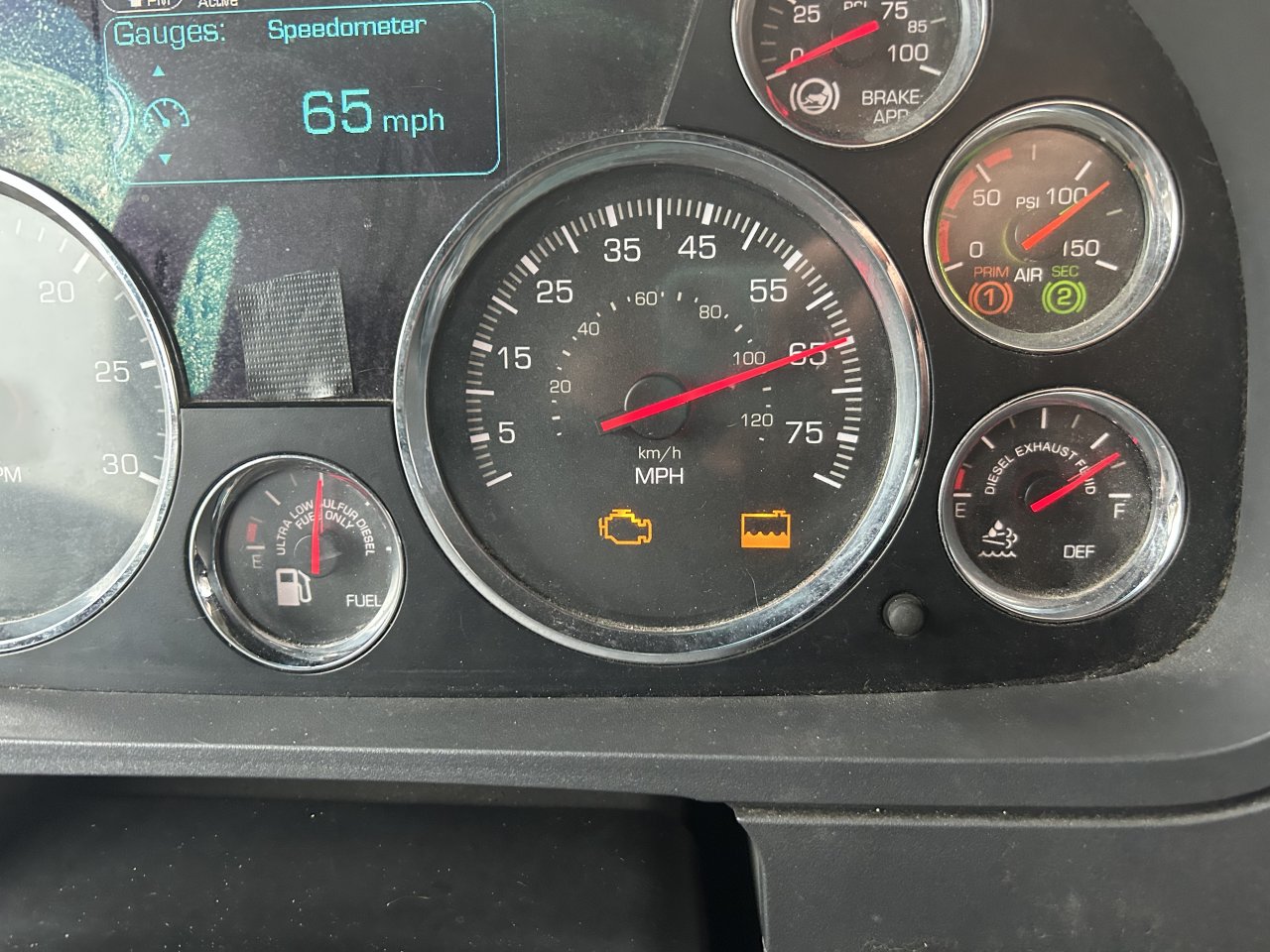

    What does the square orange one mean?

    I'm thinking low coolant level. How is your coolant temperature?

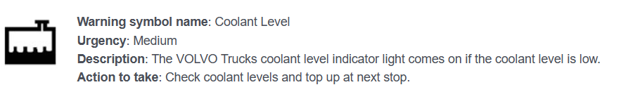

    Engine coolant level needs checked.
    Since you’re driving a PACCAR product, they’re known to have faulty sensors. I run mine 1/4” over the “full cold” mark and that has taken care of my check coolant light.

    Low coolant. Most likely just the sensor is bad.
