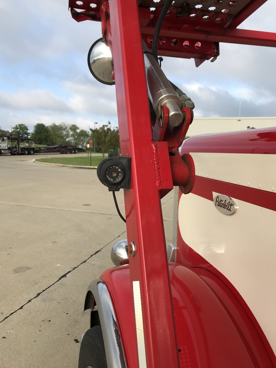

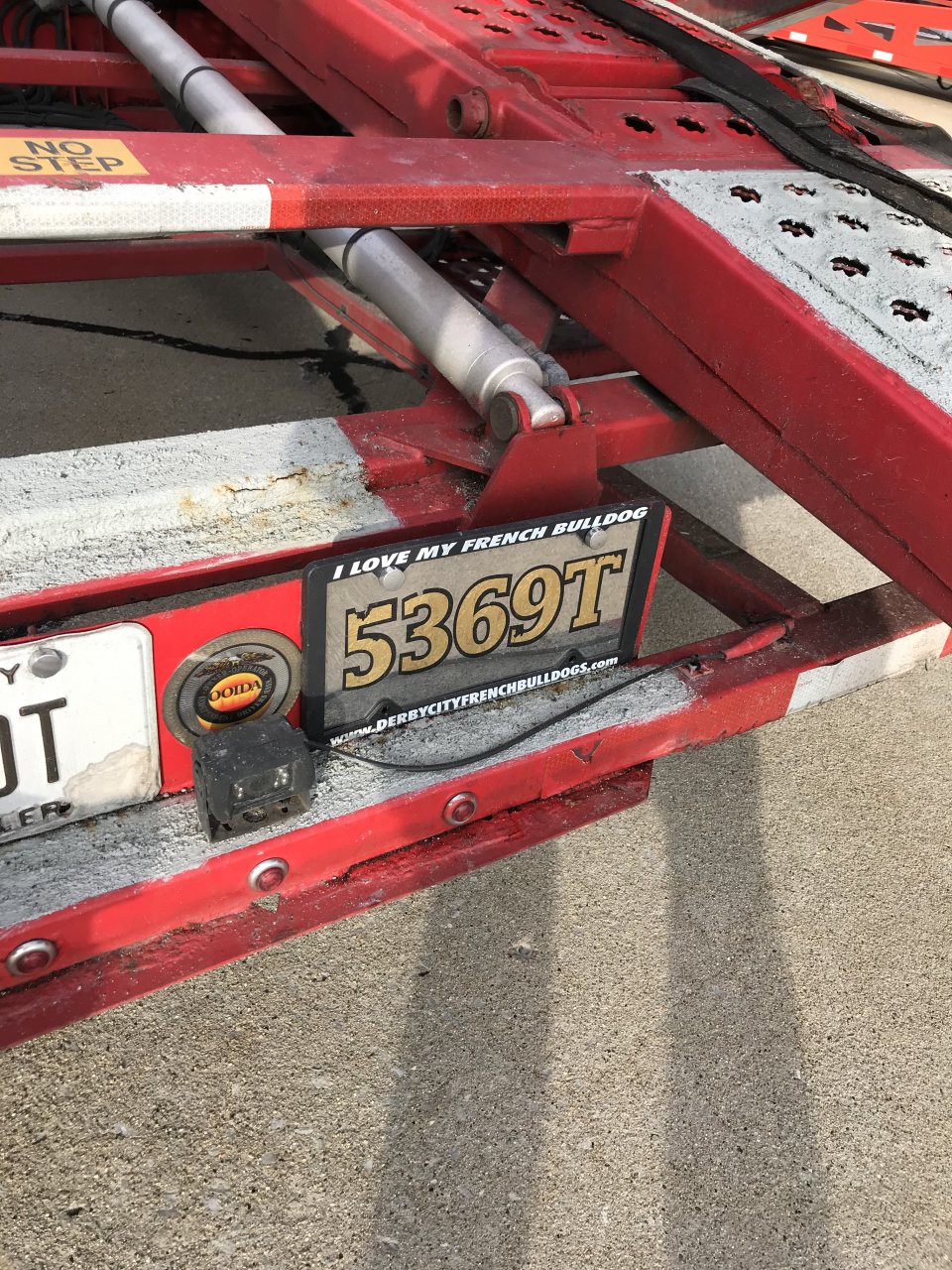

    My side cameras get very little road spray and have as good a view as my mirrors in the rain. The rear of my trailer has terrible air currents due to its design and in a torrential downpour in the dark the camera is nearly useless. During the day it is still a viewable picture. I do very little snow/ice driving but if your tail lights are visible I would assume the camera would be useable as well. FC2C1558-A088-49F0-A065-72D576942B2A.jpeg
