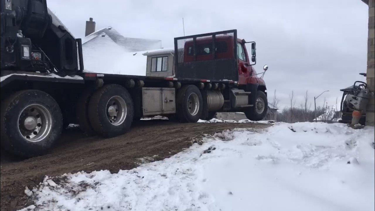

  10. Shawn2130
    Shawn2130 Heavy Load Member
    896
    1,896
    Sep 20, 2015
    Southern Ontario
    How’s this for a lift axle truck?
    Mach, Ruthless and SmallPackage Thank this.
  11. Mach
    Mach Light Load Member
    181
    139
    Nov 19, 2017
    Knoxville Tennessee
    Can't be over weight on the steers if they never touch the ground. Big brain time.
    But seriously I love it. Weird setups like that is what I like
    Shawn2130 Thanks this.
